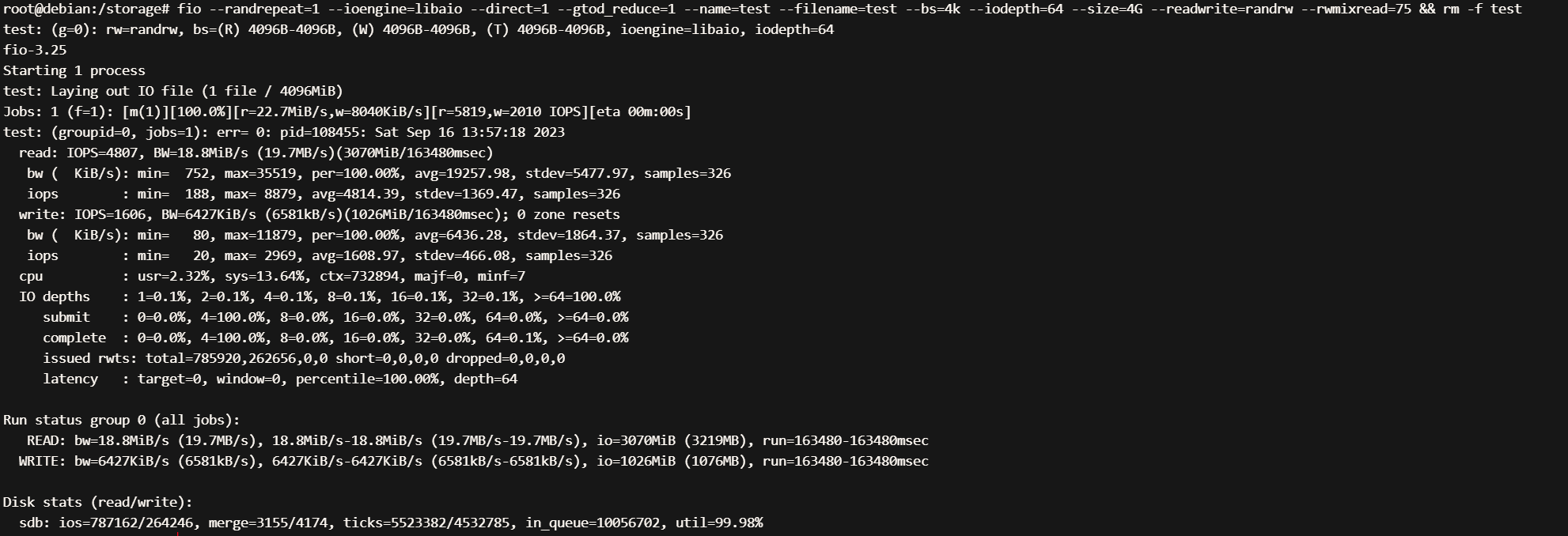

  • fio Disk Speed Tests (Mixed R/W 50/50):
    Read 1.00 KB/s (0) 1.27 MB/s (19)
    Write 1.00 KB/s (0) 1.36 MB/s (21)
    Total 2.00 KB/s (0) 2.64 MB/s (40)
    Read 6.14 MB/s (11) 809.00 KB/s (0)
    Write 6.92 MB/s (13) 871.00 KB/s (0)
    Total 13.06 MB/s (24) 1.68 MB/s (0)
    Geekbench 6 test failed. Run manually to determine cause.
    YABS completed in 59 min 55 sec

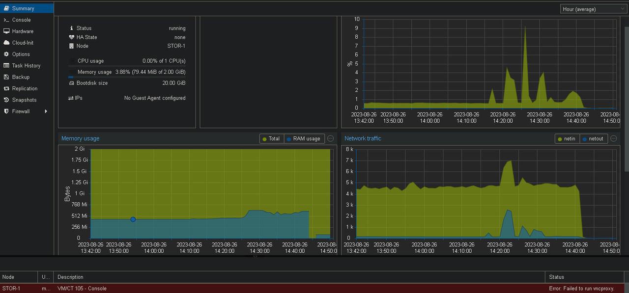

  • nullptrnullptr Member
    edited August 2023
    I can't even run htop in tmux. Otherwise, it will freeze. And my VPS got reboot automatically about one hour ago, don't know why.
    When I found things are going wrong and htop will freeze. I ran iostat, and then reboot. Now I completely lost access after rebooting it 10 minutes ago.
    Update: :'( 20 minutes after rebooting, SSH port is still closed. Can't access.
