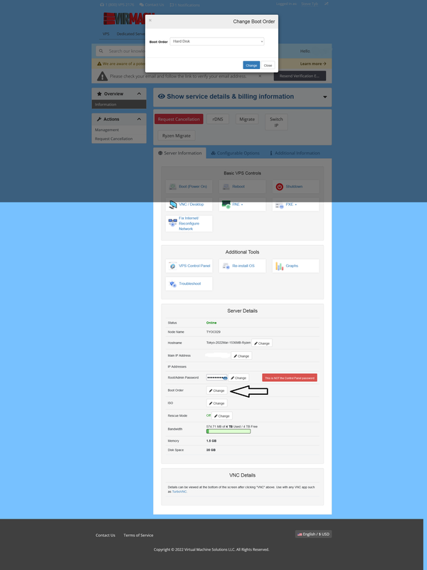

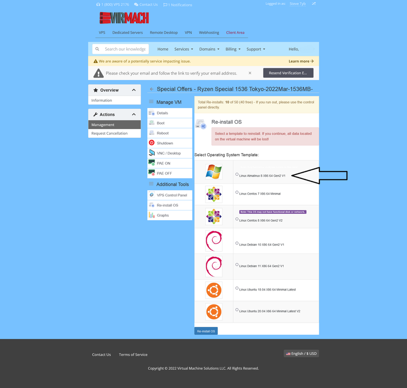

  • qpasnhqpasnh Member
    Help~
    Node Name: TYOC030
    Bandwidth: 0 B of 2 TB
    Memory: 768 MB
    Disk Space: 20 GB
    cannot be used, cannot be reinstalled:
    Reinstall PriceyVacant-VM (45.66.12x.xx)
    No media found for this virtual server
  • pddpdd Member
    @tototo said:
    @qpasnh said:
    Help~
    Node Name: TYOC030
    Memory: 768 MB
    Disk Space: 20 GB
    Have you tried Linux Almalinux 8 X86 64 Gen2 V1?
    no system
  • totototototo Member
    @qpasnh said:
    @tototo said:

    Do not use the SolusVM panel, but operate from the billing panel.
    https://billing.virmach.com/clientarea.php?action=productdetails&id=******
    Thanked by 1FrankZ
    @tototo said:
    @qpasnh said:
    @tototo said:
    @qpasnh said:
    Help~
    Node Name: TYOC030
    Memory: 768 MB
    Disk Space: 20 GB
    no system
    billing panel:
    Total Re-installs: xx of 50 (50 free) - If you run out, please use the control panel directly.
    SolusVM panel:
    Node Name: TYOC030, Bandwidth: 0 B of 2 TB, Reinstall PriceyVacant-VM (45.66.12x.xx)
    Other VPS SolusVM panels can be reinstalled. the TYOC030 vps: Reinstall PriceyVacant-VM (45.66.12x.xx): No media found for this virtual server.
    @qpasnh said:
    @tototo said:
    @qpasnh said:
    @tototo said:
    @qpasnh said:
    Help~
    Node Name: TYOC030
    Memory: 768 MB
    Disk Space: 20 GB
    no system
    billing panel:
    SolusVM panel:
    Do I really need to operate from the SolusVM panel?
    Maybe it is sort of a bug, but in most cases reinstall in the billing panel should work fine. So try following Frankz's tutorial.
    @FrankZ said:
    1. unmount any ISO that may be mounted as shown by the arrows in the image at this link
    2. Insure that you have boot from hard disk selected as shown in the image at this link
    3. Install AlmaLinux8 template as shown in this link
    4. Wait 15 minutes and tell me if the VPS shows online in the billing panel.
    If you are concerned about the 50 times limit then try reinstalling just once. If it boots fine then you can install any OS by using an ISO mount, netboot.xyz, etc.
    https://lowendtalk.com/discussion/comment/3419591#Comment_3419591
    Thanked by 1FrankZ
