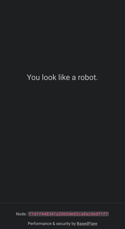

Oh, it doesn't seem to welcome me, shouldn't there be a selection box here to verify that I am human? It directly refused my access
![](https://i.postimg.cc/pVZpR1R6/Screenshot-20231211-184944-Firefox-Nightly.png)
Have you checked that you used a different browser like FF or a different chrome browser? Incognito mode?

It would be helpful to know whether private browsing modes are allowed. Is incognito browsing possibly forbidden here?
My workflow depends on accessing web-based services within the guest mode of a Chromebook.

Some countries are blocked on my instance
Yes
They are allowed
