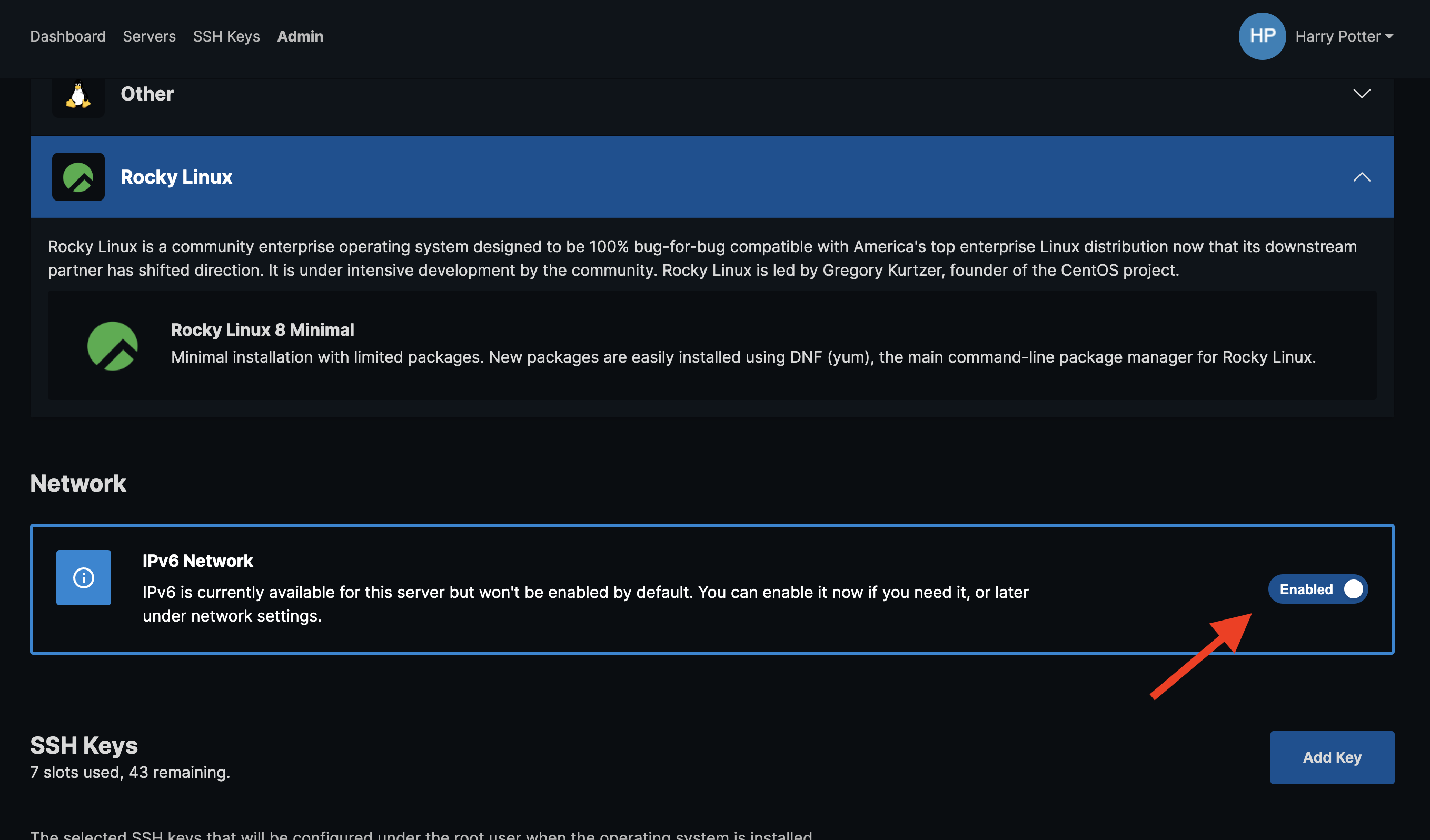

  • Interesting thread. I didn't do a great job with IPv6 in SolusVM, but I've taken a different approach in VirtFusion.
    If the provider offers IPv6, a subnet can be claimed by the customer when a VM is built, rebuilt, or if they require it later on.
