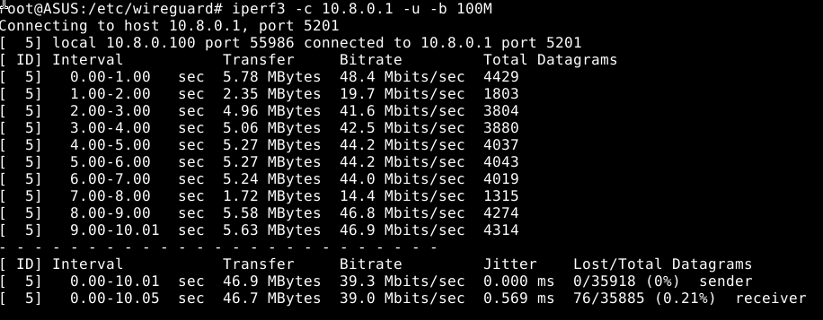

  • Entire8464Entire8464 Member
    edited April 12
    Are there any limits when it comes to wireguard?
    I'm here scratching my head as to why I'm getting no more than 3mbps download speeds with this server. It seems not to be the classical MTU problems as I went all the way down to 1280 without any difference.
    A speedtest directly from the server shows full 1gbit/s. Also running htop while doing that doesn't show a cpu spike higher than 10%. Even though I've used different low end servers for this for quite a while, this is the first time I wonder if it's like this on purpose or somehow I'm making a mistake on something I've configured over and over

    Interesting. I tried instead to run an iperf3 udp test from one server in the UK and another in Italy onto this VPS, and it seems indeed that UDP is rate limited or something similar is going on.
    Quite a disappointment to be honest; I'd expect a provider to communicate this clearly.

    So, can you run wireguard and check the speeds ?
  • MTUser2012MTUser2012 Member
    @sthosting Will you have any similar/comparable deals coming up. I missed this one.
  • zephyr32zephyr32 Member
    edited May 3
    @emperor said:
    @zephyr32 said: The mystery is solved.
    Not the best but not 1Mbits
