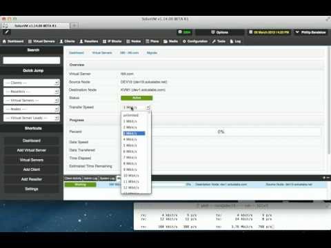

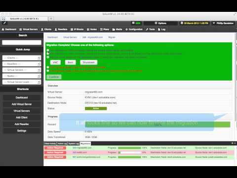

  • @soluslabs Nice! You do you implement live migration without share storage and libvirt?
  • @fileMEDIA said: @soluslabs Nice! You do you implement live migration without share storage and libvirt?
    Yeah
    These are the options for data migration
    And these are the options for shared storage migration (The vm data will be left alone)
    Oh and don't forget the live network throttling
    Nothing worse than starting a migration and it saturating the network.
