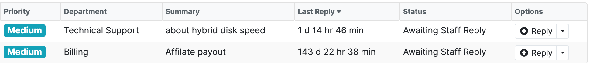

The main issue is that their support. I have a ticket #9358385 ("Affiliate payout") that had no reply for about 144 days. I also opened another ticket for disk speed 38h ago #4702123 ("about hybrid disk speed") and also has no reply yet.
I also sent a forum DM to @labze on 4 August for the first ticket above and got nothing back/ So I'm posting here as a last resort.
