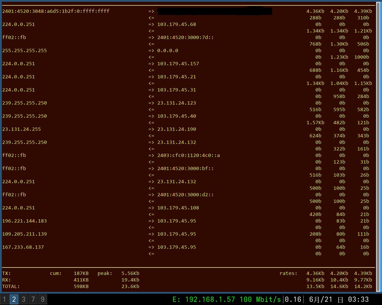

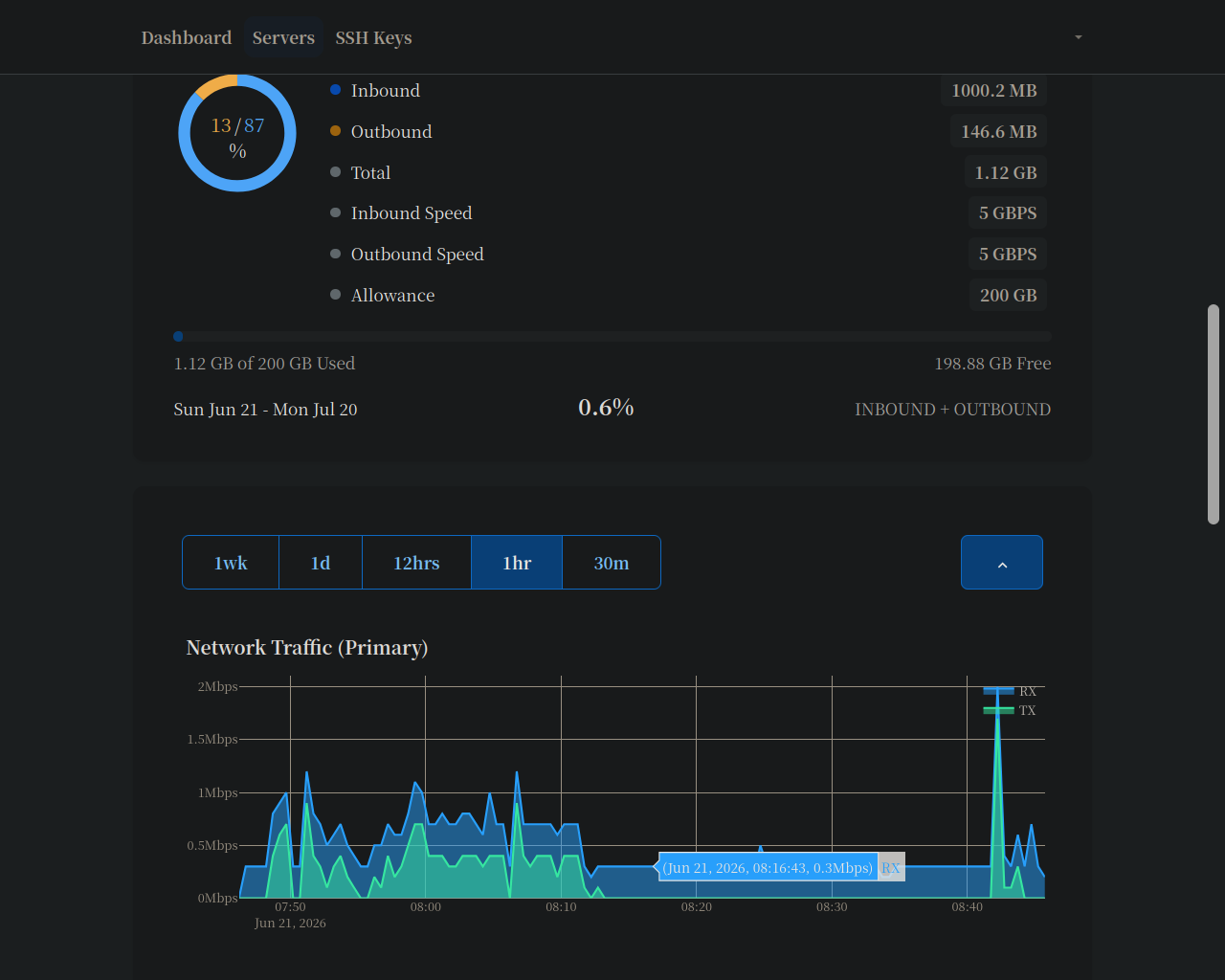

I'm a customer of Web Horizon since 2021, and I appreciate its affordable and stable services. Now, here is a problem I've encountered for 2 years, but worsened since last migration. As the title suggests, network traffic metering is not accurate at all, for 2 reasons:
  1. My VPS is IPv6-only, but when I monitor the traffic with sudo iftop -bni eth0, there are traffic from and to IPv4 addresses, and there are nothing I can do, for example sudo ufw deny 0.0.0.0/0 to 0.0.0.0/0;
    (Note in the screenshots, when no application except SSH use network, there are connections from and to IPv4, and in the following one, inbound traffic speed is about 0.2 Mbps, that is 63.28 GB per month.)
  2. The proportion of inbound and outbound traffic is abnormal as well, since this is a private VPN, the expected proportion of inbound and outbound traffic should be around 1:1, but actually it is about 6:1.
Since monthly traffic allowance is only 200 GB, and tens of GB is not consumed by me, so I really appreciate your help. By the way, I've opened a ticket in late April, which staff responded fast, that they would investigate.

    There is nothing you can do if it is broadcasted traffic.

  • @ask_seek_knock said:
    63.28 GB per month
    isn't that bad, trust me...
    I know the feeling. Actually i can offer worse percentage of included bandwidth to foreign traffic at another host. Supposedly there's some misconfiguration with VLANs but i don't really push it since the remainder is enough for me. Seems like it's kinda hard to track down or something or the recent ~20kb/s reduction actually is their fix. Like i said, i don't really care about it.
