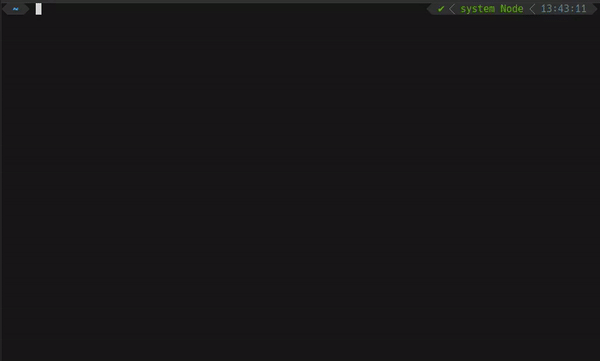

Hi,
Some users or programs provide a custom interface that you can connect to via SSH. I've looked into this and found a simple way to set it up like this:
Match User guest
    ForceCommand /home/guest/welcome.sh
    PermitEmptyPasswords yes
    PasswordAuthentication yes
    AllowTcpForwarding no
    X11Forwarding no
But what are the security implications? Could a user potentially escape the script execution and gain shell access to the system?
Thanks.
