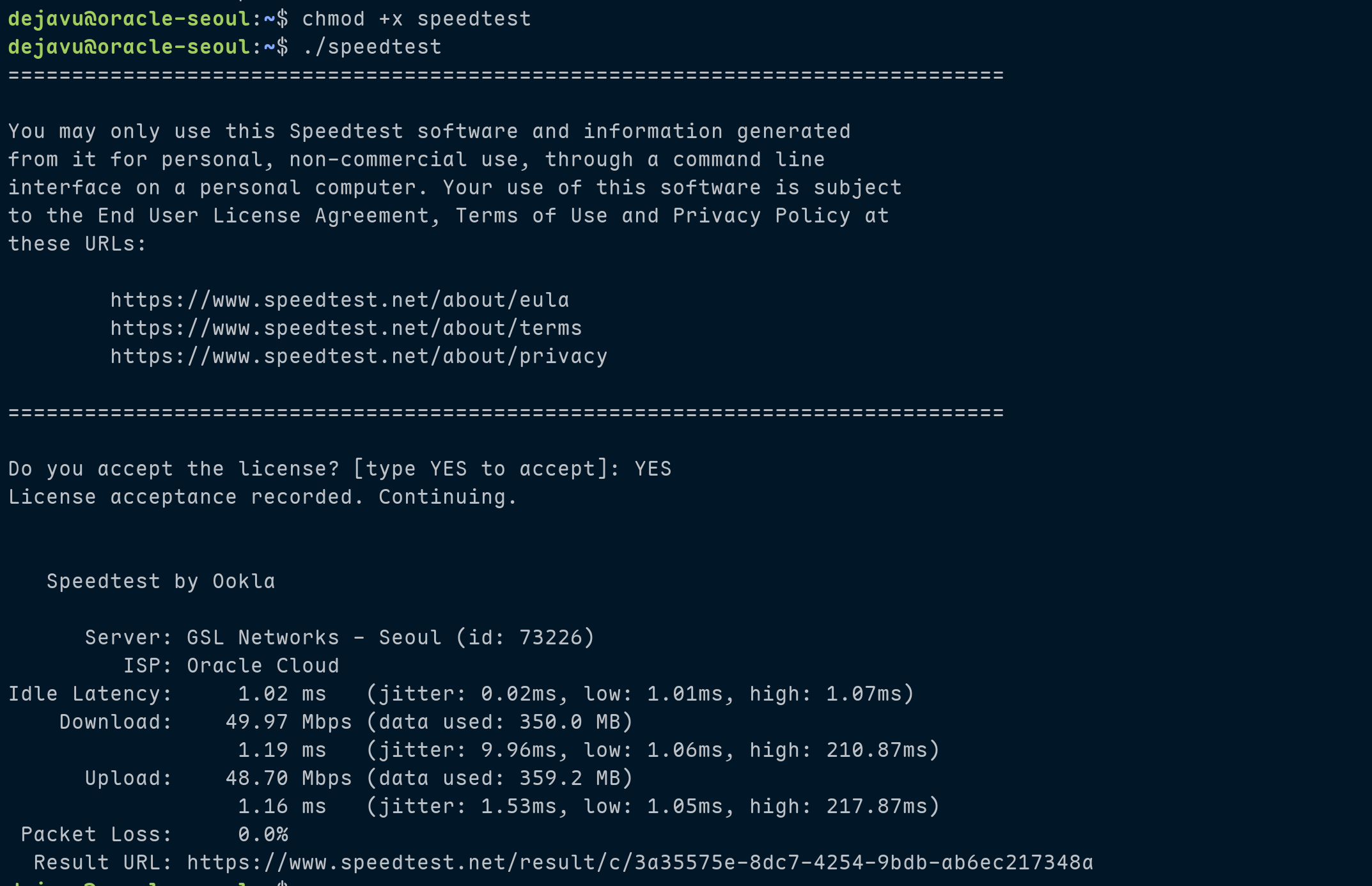

    i receive a mail noticed me that 'Oracle has scheduled a firmware update maintenance event on your instance(s).'
    I will update the net speed test result then...
    well, it’s still 50mbps……

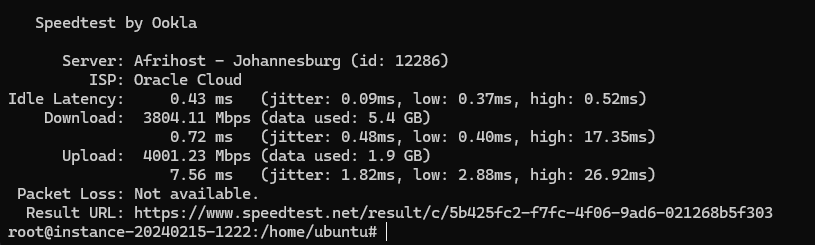

  • d1360d1360 Member
    I upgraded to PAYG but still getting capped.
    need to rebuild the vm
  • d1360d1360 Member
    edited April 25
    @DejavuMoe said:
    Ok, I rebuilt it using the option "Send diagnostic reboot" after upgrading to PAYG and it's not capped anymore.

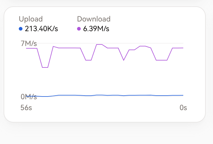

  • paul92paul92 Member
    Johannesburg (free tier) also seems to be affected.
    Hosted by Iclix Pty Ltd (Bloemfontein) [368.57 km]: 9.414 ms
    Testing download speed................................................................................
    Download: 48.76 Mbit/s
    Testing upload speed......................................................................................................
    Upload: 20.04 Mbit/s
    it seems to be inconsistent - others on PAYG are claiming reduction too...

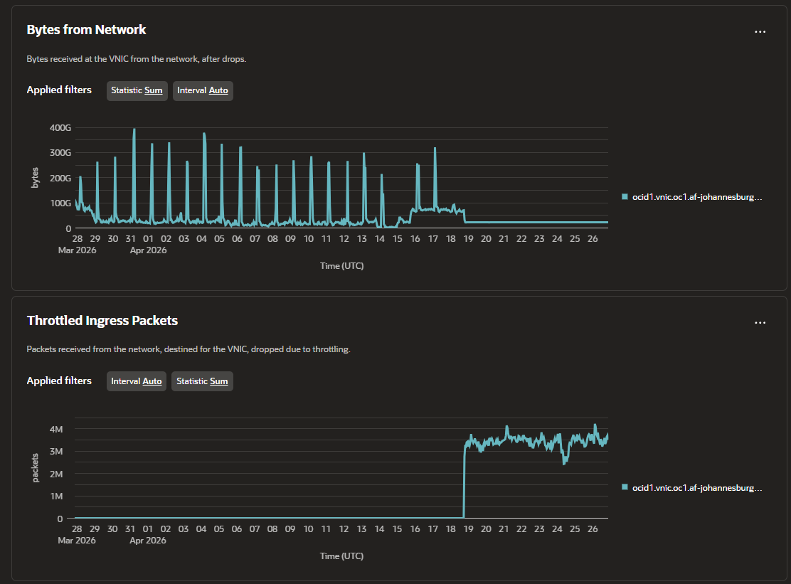

    Johannesburg, South Africa capped to 50Mbps. Started on the 19th for me. ARM instance free tier.
  • cavedogcavedog Member
    Upgraded to PAYG plan which charges 93 Euro once off which is R1865 South African Rand give or take. Did a diagnostic reboot and the throttle is gone. Just need to make sure I stay under the 10TB egress traffic, or it will start billing me for usage.
