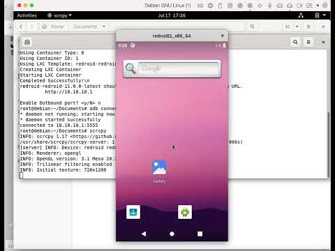

1) Firstly, execute inst.sh in Debian 11's SSH (a Debian 11 desktop is required if you want to use adb/scrcpy later in stage 2):
wget -qO- inst.sh | bash -s - -t redroid/redroid:11.0.0-latest
(this installs Redroid in Debian 11, it will install both epve and Redroid 11 as an LXC app.
!!! Caution: the first time generating redroid11.tar.xz template may take long, you should be enough patient)
wget -qO- inst.sh | bash -s - -t devdesk
(use this if you only want to install epve in Debian 11)
wget -qO- inst.sh | bash -s - -t appname
(use this if you only want to install other apps after installing epve)
you will see container run if all succeeded. You can now log in to the PVE interface at https://ip:8006 to view the redroid phone container.
2) Secondly, (if you have installed the Debian 11 desktop)you can connect to Redroid with adb and view the Redroid screen after container run:
apt-get install adb scrcpy
adb connect 10.10.10.1:5555
scrcpy
you will see redroid screen if all succeeded.
