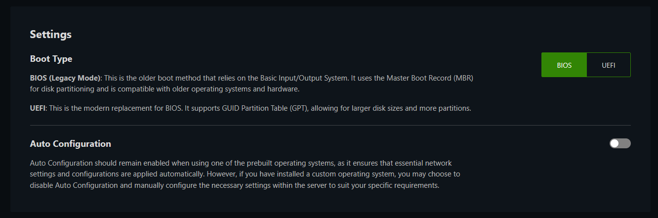

Some panels like ISPSystem are very aggressive and will just modify the disk raw and install. There's not really much you can do against that, besides LUKS.
Virtfuuuuuuusiooooooooon
also sometimes it applies with netplan and not interfaces file
just chattr +i
Are the you person that is emailing providers about moving to Virtfusion currently ?
I'm not that insane
