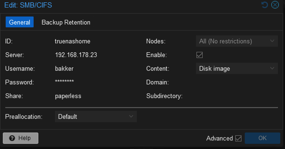

    i looked at proxmox and idk how can i change the group
  • figured it out !
    i needed to add options vers=3.0,uid=1010,gid=1010 to /etc/pve/storage.cfg

    figured it out... appended to a group and appears to work fine
    options vers=3.0,uid=101000,gid=110000
    and uuid group lxcshares is 10 000
    and user paperless 1000
    so works fine, now i need to duplicae the containers and see how that all works...
