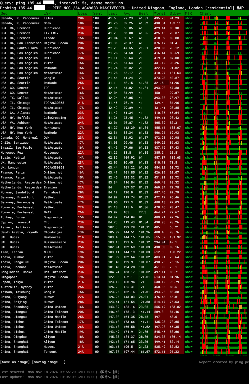

  • There are also network issues at the London data center.
    Thanked by 1sucre13
    Hey mind sharing what tool that is? I wanna use it on my VPS when I get home to see if I'm getting the issue.
  • https://ping.pe/1.1.1.1 (just change IP)
    Click 'Help' on top right for more interesting things it can do. Also MTR's show up after 10-12 seconds and can be opened with 'show' to nail down network issues.

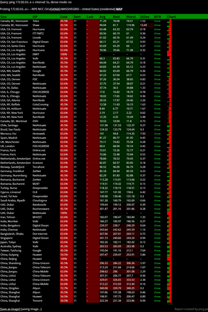

  • tribaltribal Member
    edited November 2024
    And this is mine from NY
    I have so many questions for the company >:)

  • @Kevinf100 said:
    You are lucky. My IP is all red with packet loss 50-65% and it's starting to get annoying.
