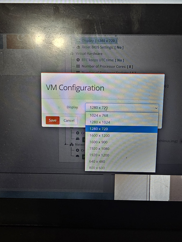

    Ultravps might be able to set your resolution manually, I'm using npulse bvcp and I have option. If you need something to test on just lmk.

  • k9bangerk9banger Member
    edited November 2024
    @akaemu said:
    @k9banger said:
    @jsg said:
    You do know that you can VNC into a Bhyve guest, right?
    That is what I'm doing and the screen in both terminal and X11 mode is set at 640x480
    Done that it didn't work.
    There is even a BIOS setting to change that. It didn't take.
    In any case the DHCP is more important. Newer things are supposed to be better in functionality not worse.
