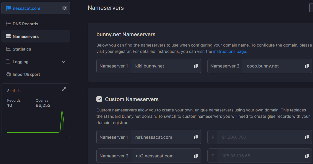

  • Bunny.net DNS is pretty easy to set up.
    Thanked by 1nick_
