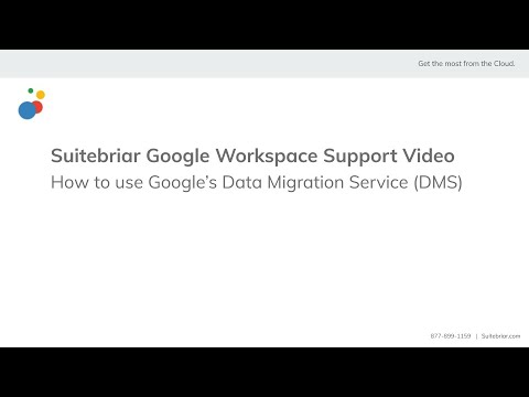

  • I should add that this is an online service to migrate email between google workspace accounts.
    It didn't work at first which is why I created this thread. I had to select gmail as the type of migration which fixed the problem.
