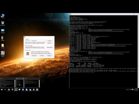

So there are the few lines of scripts in the Rescue mode
apt update && apt install -y qemu-kvm
wget -O /root/install.iso http://ftp.debian.org/debian/dists/buster/main/installer-amd64/current/images/netboot/mini.iso
qemu-system-x86_64 \
  -enable-kvm \
  -cdrom /root/install.iso \
  -hda /dev/sda \
  -m 2G \
  -net nic -net user \
  -vga std \
  -vnc localhost:0 \
  -usbdevice tablet \
  -boot d
After the VNC is initiated in the QEMU, I setup a SSH tunnel and VNC to localhost:5900 to start installation. Region/location/Repo URL/Time zone, all direct to US/America, HD set to use the whole disk/partition. Network hardware works OK, hard disk(2T) works too, or AlmaLinux would have failed.
So, where is the problem?
