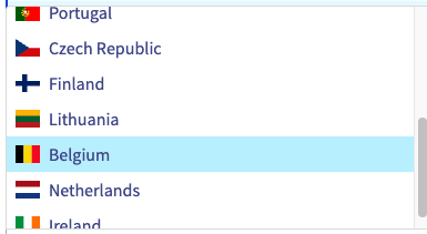

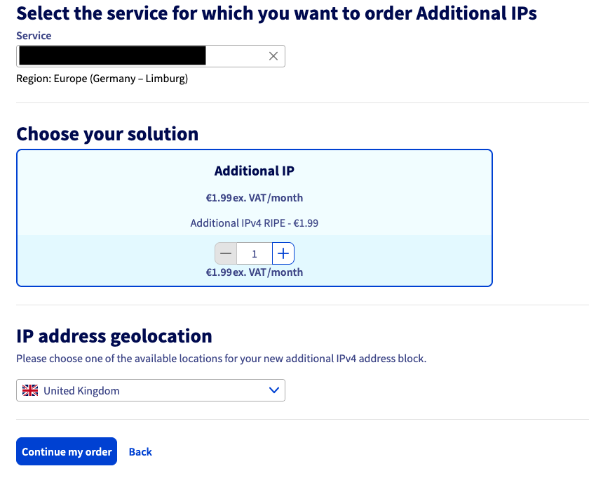

    You can do that with OVH. Buy an additional IP and choose UK IP to add to your OVH Germany vps.
    And also curious about this, like they let you purchase an IP from range that's normally used in another OVH location?
    I think that'd be perfect for @citadella .
  • conceptconcept Member
    edited August 2
    Yes you can choose from a lot of different EU countries.
