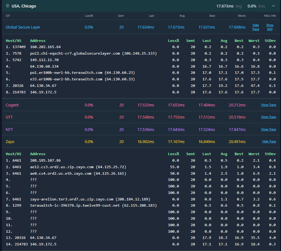

I was wondering is there was a possibility for me to buy any Chicago VPS to get those 14ms I am not really sure what I am doing I am asking because I don't really know.

No its not possible to achieve that latency because that is direct connection between zayo routers on each side. Testing from a vps will give you more latency because it has to go through your provider router/switch and hypervisor. Even if Chicago vps provider has zayo as upstream, there is no guarantee it will use them. It looks like the best you will get is 17 ms.
Running Globalping against every Chicago server shows 17ms absolutely lowest for reference @Danilo , you won't get lower than 17ms from NJ<>CHI

TNAhosting is 17-18ms away from your ip, and they are located in Chicago. I think that is best you could ask.

It's about 17.7ms from hosthatch and 18ms from tnahosting. These are likely the lowest figures you'll see.
That'll be as low as you get, won't go lower than that for now

Best I see is 17-18ms here.
Columbus or Cleveland will get you 14ms to your test IP.

This is done often in the market with dark fiber companies we have noticed over the years. However if they have an extra splice or two come up now it's 14.2ms then 14.3ms etc.
Most of those are directly from their end points as well which means once it goes from their racks to another provider even in the same DC you're talking another 2-4ms which is why you see the 17-18ms is more realistic real world times.
If it has to go another route or via another provider as someone else mentioned it could add to this for you.
