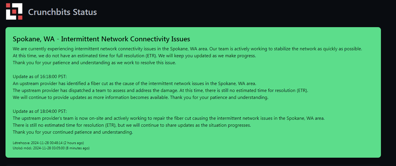

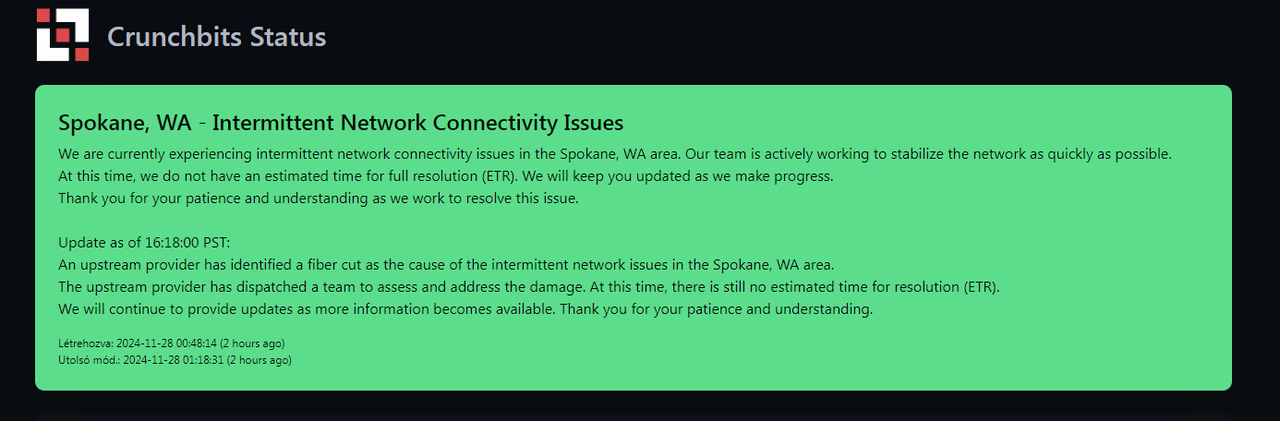

  • Spokane, WA - Intermittent Network Connectivity Issues
    We are currently experiencing intermittent network connectivity issues in the Spokane, WA area. Our team is actively working to stabilize the network as quickly as possible.
    At this time, we do not have an estimated time for full resolution (ETR). We will keep you updated as we make progress.
    Thank you for your patience and understanding as we work to resolve this issue.
    Update as of 16:18:00 PST:
    An upstream provider has identified a fiber cut as the cause of the intermittent network issues in the Spokane, WA area.
    The upstream provider has dispatched a team to assess and address the damage. At this time, there is still no estimated time for resolution (ETR).
    We will continue to provide updates as more information becomes available. Thank you for your patience and understanding.

  • Update as of 18:04:00 PST:
    The upstream provider's team is now on-site and actively working to repair the fiber cut causing the intermittent network issues in the Spokane, WA area.
    There is still no estimated time for resolution (ETR), but we will continue to share updates as the situation progresses.
    Thank you for your continued patience and understanding.
