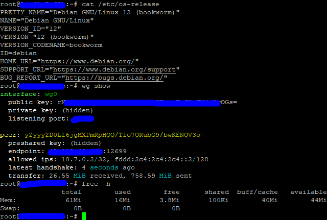

  • @Raspi_dude said:
    I was looking around on microlxc.net and noticed that they have a plan with only 64mb of ram. What could be some use cases for these tiny servers?
    An image is worth a thousand words.

  • @jwg29859 said:
    16mb used is mind blowing :o
