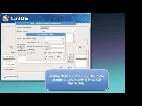

I need to know what to do, I have a raid1 with 2 disks, and when I boot I get an image like this one: http://linuxmoz.com/how-to-install-centos-6-linux-for-servers-desktops/ just after the image that have the "use all space" option selected
in this case there is a lv_root ext4 and a lv_swap with 2gb called swp
in this situation what will I have to do? to delete both and create a new lv_root with 80gb and a lv_swap with 4gb? what is the normal action to do here?

is this the correct way
but it seems LVM partition is this the correct way to do it at solusvm?
