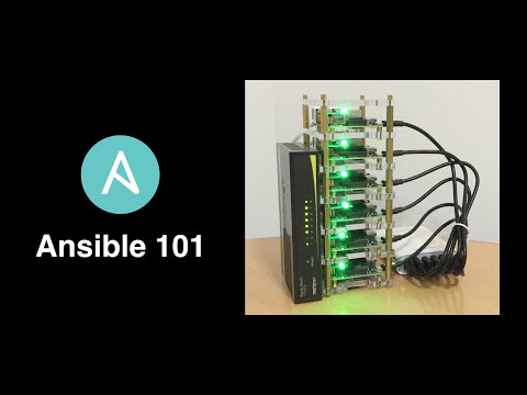

    Ansible for management. Might take a little to wrap your head around but it is incredibly powerful.
    The above link is a good introduction into Ansible using a cluster of Raspberry Pis to demonstrate, but it's exactly the same for any server.
