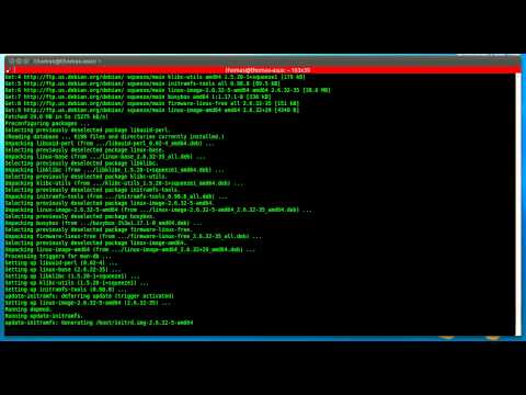

  • I could write a howto but I did this stuff with a dedicated server, not with a virtual server like KVM/OpenVZ.
    It is easy if you are able to boot your server in some kind of netboot. If not you will have to do everything on your running system which is complicated. EDIS have in their admin panel some kind of rescue boot. Or you could boot in any other live system without mounting your disk.
    After booting in this rescue/live system you should partition your disk and encrypt partitions with cryptsetup.
    Here is a video howto for a dedicated server but it should work in the same way with KVM:
    I would recommend testing this with VirtualBox on your local machine.
