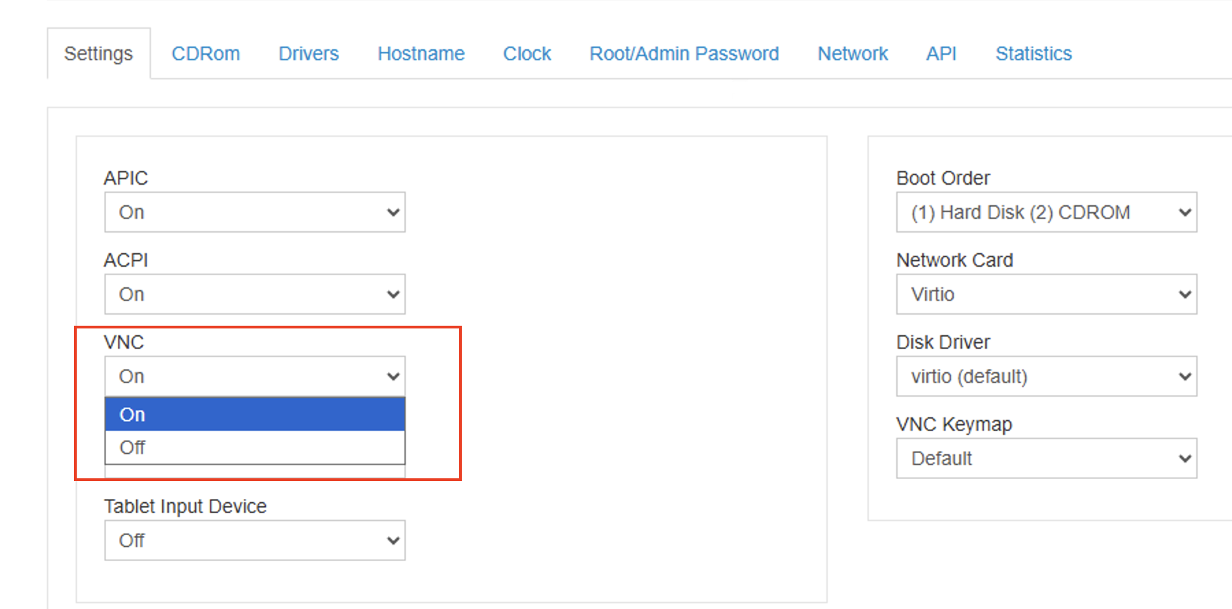

    The most common way customers got hacked when I used to run SolusVM was that they signed up with a trivial password initially with a plan to change it later.
    Not realising that this sets your VNC password and that VNC is enabled as standard and publicly listening. So you change your root password but the VNC password is still the first 8 of whatever you entered e.g. password or secureme etc etc
    If someone knows a providers IP ranges it's trivial to scan known solusvm VNC port patterns and then dictionary attack them.
    When you get a hit, you then just restart the VPS via VNC change it to rw and run init to reset the root password.
    Sound familiar?
    It happened about once a week to someone minimum until I did some hacking around to randomise the VNC password on creation.
    If this is what happened, the host is not compromised, the sign up process just allows weak or predictable passwords.
    Probably time to consider VirtFusion anyway, it's the natural evolution and not vulnerable to this in the same way.

    In the meantime, I will also say that VNC handling, has improved somewhat throughout more recent SolusVM releases. Customers also have the ability to disable VNC entirely for their VPS directly within the panel under the "Settings" tab of the VPS if they do not use it (see below screenshot), which can provide some additional peace of mind. It can always be re-enabled later if/when needed.
    Either way, I appreciate you sharing the context and experience here. It's definitely relevant information for us to keep in mind as we review what happened in this particular case.

    Well, I have to say, it looks exactly the same to me tbh, I did not think they were doing any more work on SolusVM v1 since losing all of the original development team, but I have had my head in other places for the last 4 years.
    How it used to be:
    • The root password the customer enters into the form on sign-up sets the VNC password.
    • The VNC password, regardless of length, used to, at one point, just accept the first 8 characters.
    • VNC was enabled as standard
    • VNC ports were publicly exposed for direct connections using VNC clients.
    I mean this without any disrespect, and I am sure you already know this, but telling the customer how to work around security issues baked in as standard and then expecting them to read it because it's in an email, FAQ, or terms... I think the polite word is inefficient.
    A couple of workarounds: WHMCS hooks to randomise the vnc password. Firewall external access to the VNC ports and only allow your hypervisor IP's or master IP if you use the master as the wss relay/proxy.
