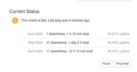

  • JasonMJasonM Member
    @fijxu said: Hi yeah the servers are dead.
    7 times downtime in first half of June. WTF! Still another 14 days are remaining. You can expect downtime similar to May 96% - and thats bad even for shared web hosting.
