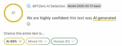

  • radexradex Member
    @fluffernutter said:
    @Obelous said:
    @patrick7 Are you writing with AI? this smells like AI...
    yeah probably. robot detected, opinion discarded. probably a user issue.
    That AI Detection is useless af. Just typed normal Stuff, everytime it told me it's AI.
    maybe you're a robot! do you have issues with captchas?

  • radexradex Member
    Perhaps you're so naive that you believe all the rubbish this AI detection claims about.
