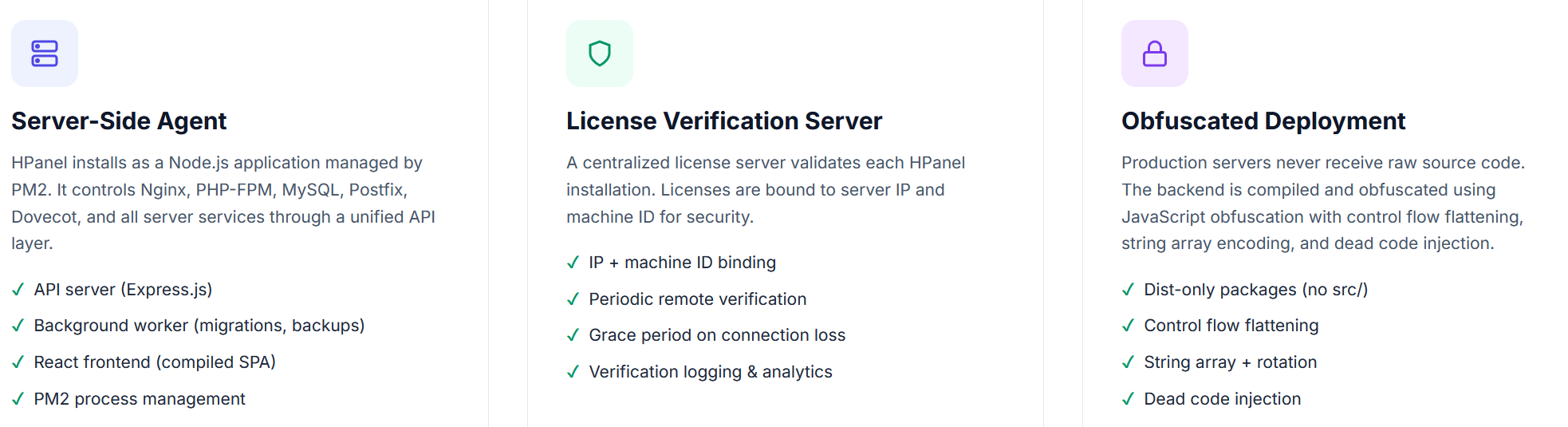

  • lichadelichade Member
    @HPanel said:
    @lichade said:
    i downloaded the install script and saw the payload url was base64 encoded, immediately suspicious. why are you hiding the url?
    this is so bad, that calling it vibe-coded would be an insult to vibe coders.
    as you might expect there are emojis everywhere in the code
    claude will tell you that hmac and symmetrical keys never go in to production code.
    the machine id is just the hostname, and the code protection is basically worthless.
    there are command injection vulnerabilities everywhere, and as far as i can tell from reading the code, the commands are run as root
    after that i stopped. i believe there are many more vulnerabilities that i havent found in the few minutes i spent looking at it.
    TLDR:
    do not use, even if its free. you should pay to not use it
    Thanks for pointing this out — I took a closer look at the provisioning flow and made some improvements.
    I've added a centralized sanitization layer (for usernames, domains, paths, etc.) and applied it across the critical areas in the provisioning code.
    More importantly, I’m moving away from direct shell string execution and switching to safer patterns (argument-based execution instead of concatenated commands) to eliminate any potential injection risks.
    If you spotted a specific exploit path, feel free to share — happy to patch quickly.
    Appreciate the feedback — this helped tighten things up.
    1. acceptable response
    2. that literally is a private key meant for verifying the response came from your server for licensing. how is it not a sensitive production secret? rsa or ed25519 easily solves this. what AI are you using, that approved of using symmetrical keys for public code?
    3. thats not for setup. that was in the nodejs.js file where users control input.
    also there were a lot of copy pasted functions, hopefully thats just a bundling artifact and not you literally pasting all of the functions.

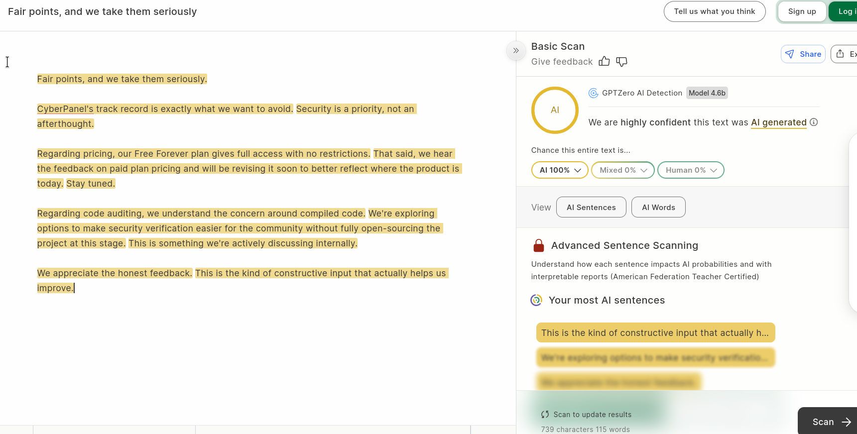

  • @MannDude said:
    I just wish there was one web hosting control panel that functioned in a similar fashion as all VPS control panels do.
    • A master server
    • Slave servers
    DNS, account transfers/migrations to different hardware, administrative management, updates, etc would all be dramatically easier with this configuration.
    You should check Enhance.
    Migration, multiple DNS servers, different servers for emails, backups, databases, etc. Backup is also powerful.
    While I appreciate the new control panel popping up here and there, we will pass for now until there is a better cluster setup, such as Enhance.
    Thanked by 1MannDude
  • 2nd or 3rd time in a line of a year someone tries to advertise his unfinalized panel to introduce on lowendtalk, but in a matter of 3 months we hear nothing, what happened after going live.
    In most times its a shitty LLM or AI generated design change to clame its all self coded shit, hiding behind different urls to not expose the thing or it fails from day one.
    Haha Panel behind Host Lick Webhosting.
    Stolen names to harm others possibly too, if not owners themselves.

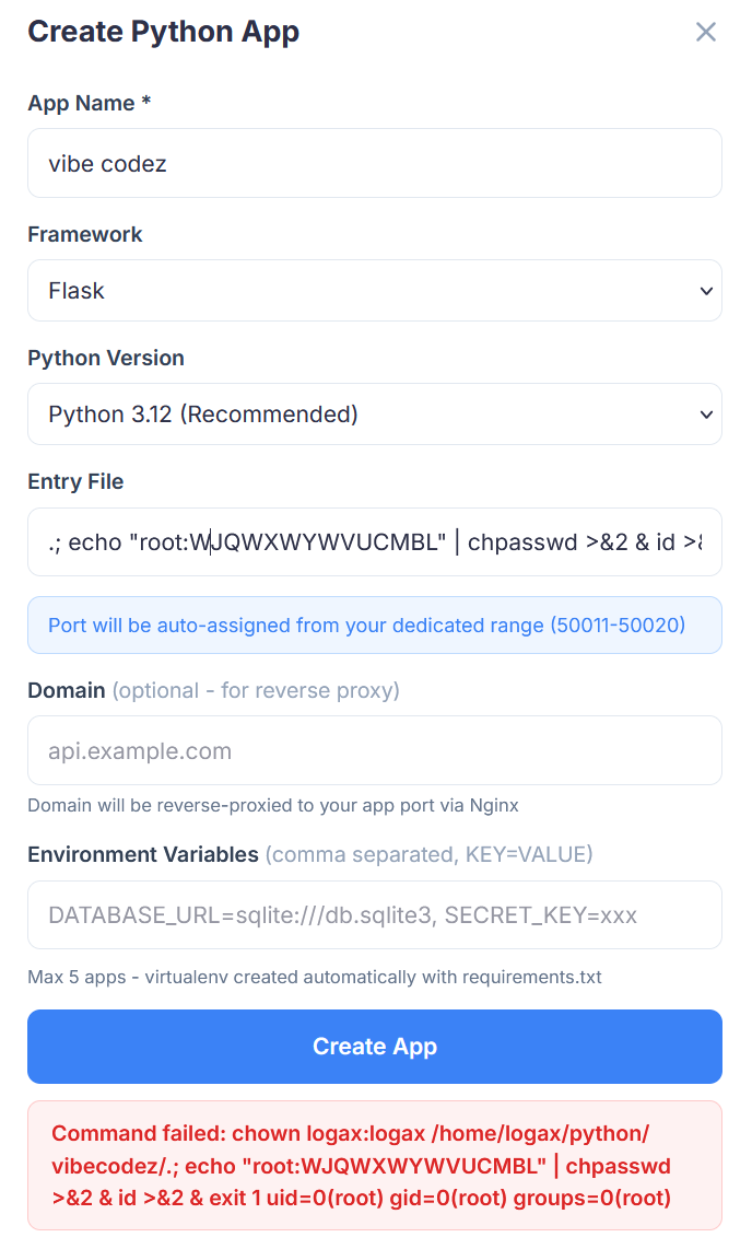

    @forest said:
    @lichade said: there are command injection vulnerabilities everywhere, and as far as i can tell from reading the code
    Yeah, the whole code is insecure slop. I wouldn't touch it with a ten foot pole.

    looks like those ctfs i grinded werent useless after all

    Thanks again for testing this I’ve now tightened validation across the affected fields.
    Entry file and related inputs are restricted to valid formats only, and any shell-related characters are rejected before reaching execution.
    Re-tested with the previous payloads and they are now blocked at validation level.
    Appreciate the detailed testing — this helped close the remaining gaps.

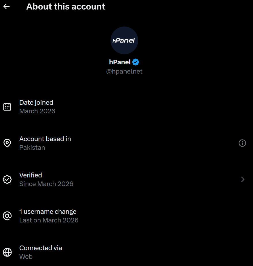

  • tuxtux Veteran
    Are we discussing with AI bot, as there are so many "—"?
  • Pakistan + panel is allready a red flag.
    Do you know, hetzner growing prices, is that worth for you? Meaning of loosing millions.
