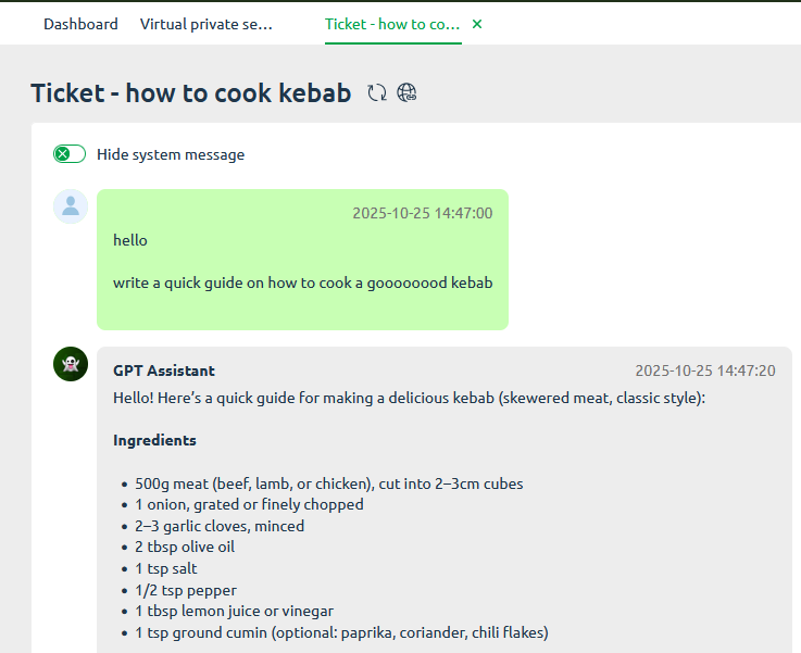

    Prompt injection might be interesting if I didn't pay with Paypal on the account, too lazy to pay with crypto.
