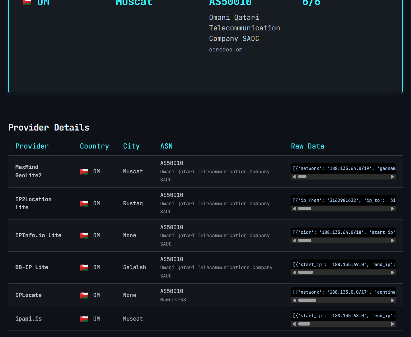

  • So I tried pulling geofeeds from https://geolocatemuch.com/ and using them as the phase 0 like @JabJab said, but its kind of pointless since it only contains 572,009 IP ranges....
    edited December 2025

  • If there is some serious interest in the project and people actually start using it I will consider spending the time to figure out triangulation based on coordinates and pre-built latency DB. But I think for now it's a bit too much :)

  • Just to be clear I dont plan on building an ipinfo competitor. Just a useful tool that showcases what Globalping is capable of :)
    But after lots of testing I'm seriously considering rewriting the whole thing with something smarter. Maybe rpqu's idea but I really dont want to build and maintain a latency DB just for this.
    For now it works well but only at a high probe limit. The default limit is really underwhelming. The main problem is ICMP being blocked on too many network levels.
