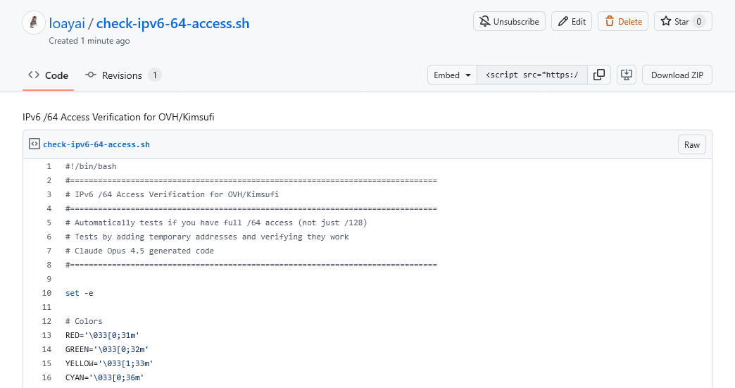

  • Created this with Opus 4.5
    https://gist.github.com/loayai/8eb1fa456246202a4deece7780725da6
    Example output :
      IPv6 /64 Access Verification
    ▶ Detecting IPv6 Configuration
      ℹ Interface: eno1
      ℹ Primary IPv6: 2001:41d0:x:xxxx::1/128
      ℹ Your /64 block: 2001:41d0:x:xxxx::/64
      ℹ Gateway: 2001:41d0:x:xxff:ff:ff:ff:ff
      ✓ IPv6 connectivity confirmed
      ℹ Generated 3 test addresses
    ▶ Testing /64 Address Space
      Testing (1/3): 2001:41d0:x:xxxx::7e57:1
      ✓ Added to interface
      ✓ Address is active
      Testing (2/3): 2001:41d0:x:xxxx::7e57:2
      ✓ Address is active
      Testing (3/3): 2001:41d0:x:xxxx::7e57:3
      ✓ Address is active
    ▶ Testing Outbound Connectivity from New Addresses
      From: 2001:41d0:x:xxxx::7e57:1
      ✓ Outbound connectivity works
      From: 2001:41d0:x:xxxx::7e57:2
      From: 2001:41d0:x:xxxx::7e57:3
    ▶ NDP Proxy Requirement Check
      ℹ NDP proxy is disabled (will need for VMs)
      ℹ IPv6 forwarding is disabled (will need for VMs)
      ℹ ndppd not installed (required for VM IPv6)
      Note on Inbound Traffic:
      OVH uses NDP instead of routing your /64. This means:
      • Inbound traffic to VM addresses requires NDP proxy
      • Without ndppd, VMs won't receive incoming IPv6 traffic
      • Outbound from VMs may work but replies won't return
      SUMMARY
      Your IPv6 Block:  2001:41d0:x:xxxx::/64
      Addresses Tested: 3
      Successfully Added: 3
      ✓ /64 ACCESS CONFIRMED
      You can use the full /64 block for your VMs!
      Available range:
      2001:41d0:x:xxxx:: through 2001:41d0:x:xxxx:ffff:ffff:ffff:ffff
      NEXT STEPS FOR PROXMOX
      1. Install NDP Proxy daemon:
         apt install ndppd
      2. Configure /etc/ndppd.conf:
         │ route-ttl 30000                                    │
         │ proxy vmbr0 {                                      │
         │   router yes                                       │
         │   timeout 500                                      │
         │   ttl 30000                                        │
         │   rule 2001:41d0:x:xxxx::/64 {                     │
         │     static                                         │
      3. Enable IPv6 forwarding:
         echo 1 > /proc/sys/net/ipv6/conf/all/forwarding
         For persistence, add to /etc/sysctl.conf:
         net.ipv6.conf.all.forwarding = 1
      4. Start ndppd:
         systemctl enable --now ndppd
      5. VM Configuration:
         • Bridge: vmbr0
         • IPv6: Any address from 2001:41d0:x:xxxx::/64
         • Gateway: 2001:41d0:x:xxxx::1 (Proxmox host)
      Example VM config:
         IPv6 Address: 2001:41d0:x:xxxx::100/64
         IPv6 Gateway: 2001:41d0:x:xxxx::1
