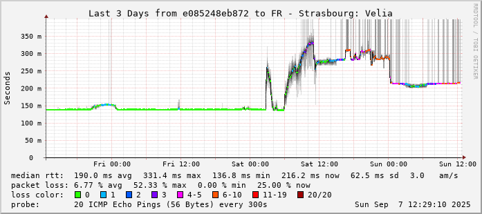

Personally, can confirm increased latency and packet loss to Europe from my probe in UAE.

ovh france servers latency increased from 120ms from my place in india to 450ms traffic routing through singapore

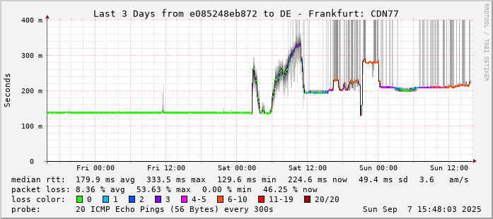

I see significantly higher latency and lower download speed from @HostDZire's Mumbai DC to most of my european targets. Funnily though I also see a few targets with actually better results than usually (ie. before the current fiber problem), e.g. and particularly plusline.net (DE) which has over 100ms lower latency currently as well as about 50% higher DL speed!

The current state, as seen from Mumbai, didn't change (not significantly anyway). Most european targets show around 200 (tendency 250) ms to about 300 ms - now with 2 exceptions, both DE: plusline and core-backbone the latter even better (ca. 10%) than the former, both in latency and download speed.
Somewhat strange because AFAIK usually cables (from ASOC) land in FR, Marseille or in the UK. So, maybe in NL (which is very near DE), but nope, the NL results are very similar to the UK results and many others.
A look at the route shows that it seems to go via SGP, Reliance directly to DE, FRA core-backbone; latency is about 110 ms.
Then, for comparison, I checked the route to NL, AMS (@Clouvider and xtom). Those routes also go via Reliance and SGP but are over 100 ms (actually more like 150 ms) slower.
So it looks like most routes to Europe (from India), at least currently, go via SGP, but a few like e.g. core-backbone and plusline have found a way better route "around" the Saudi Arabia bottleneck.

Well, around 250 ms from Mumbai to most of Europe does look quite bad to me.
But again, my main point is how come that 2 european providers/networks are very significantly better/lower latency than the rest?
One suspicion I have is that they simply react quicker and quite likely have alternative routes ready "in the drawer" if needed.

I can confirm it has gotten much worse in Mumbai. I have a home connection, and 2 servers in Mumbai and both are reporting significantly higher latency to my Netcup Vienna chicken. Normally the ping is 150ms and yesterday after this underseas cable news, it was 220ms+ and today it has gone worse to 300ms. It is now being routed via singapore to US, Santa Clara and then to Europe.
Edit: If I use Cloudflare WARP, the Cloudflare routing takes me through normal EU route but I'm still seeing elevated latency. Netcup's IPv6, however, is still showing 262ms ping.
