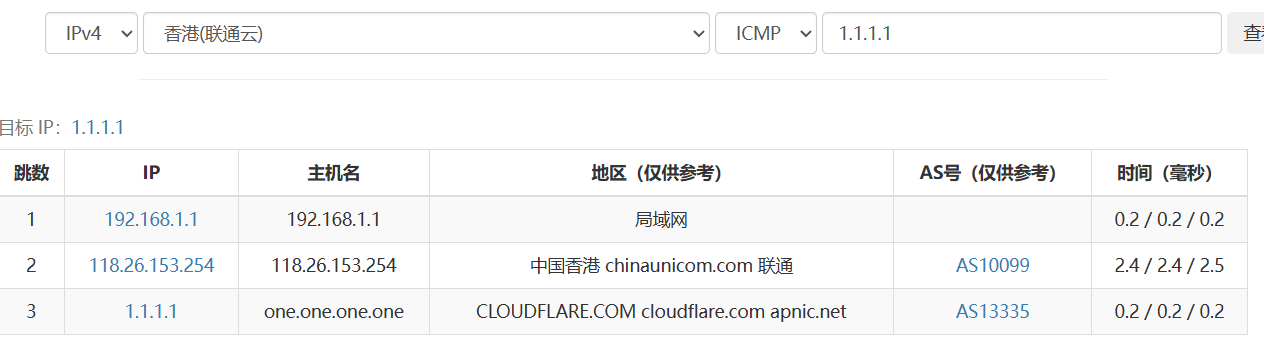

  • Unicom cloud ?
    Probe IP https://ipinfo.io/118.26.153.43
    PING 1.1.1.1 (1.1.1.1) 56(84) bytes of data.
    64 bytes from 1.1.1.1: icmp_seq=1 ttl=253 time=0.380 ms
    64 bytes from 1.1.1.1: icmp_seq=2 ttl=253 time=0.236 ms
    64 bytes from 1.1.1.1: icmp_seq=3 ttl=253 time=0.230 ms
    64 bytes from 1.1.1.1: icmp_seq=4 ttl=253 time=0.226 ms
    --- 1.1.1.1 ping statistics ---
    4 packets transmitted, 4 received, 0% packet loss, time 2ms
    rtt min/avg/max/mdev = 0.226/0.268/0.380/0.064 ms, ipg/ewma 0.710/0.330 ms

    could u please ping 172.65.175.107? thanks
