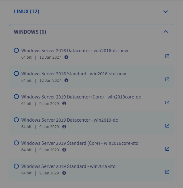

  • RurikoRuriko Veteran
    Can you install the Windows Hyper-V Server 2019 from the ovh template?

  • s0n1cs0n1c Member
    ovh does not provide windows templates
    @s0n1c said:
    That's weird cause I have it for my box. Anyway I had a similar problem where I couldn't install any windows version so I thought I'd try using one of their windows hyper-v templates just to see if their own template would install which didn't but it did prompted the automated system to alert technicians that it failed to install which got them to do a hardware diagnose. It took about half a day to get it fixed although they didn't really tell me what they fixed since their automated message said : Installation will resume

  • s0n1cs0n1c Member
    @Ruriko said:
    @s0n1c said:
    Odd, i dont see this option. That saying, it only goes up to Windows Server 2019, which I can already install. I want Windows server 2022 and up or Windows 11 which is what fails.
