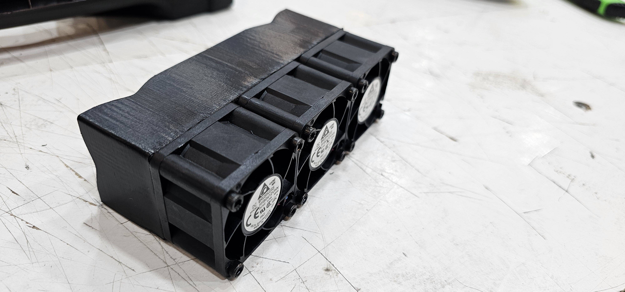

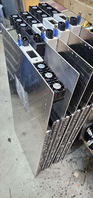

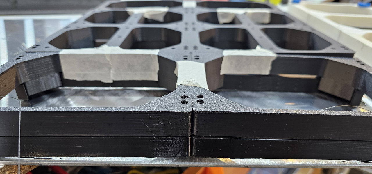

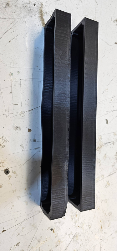

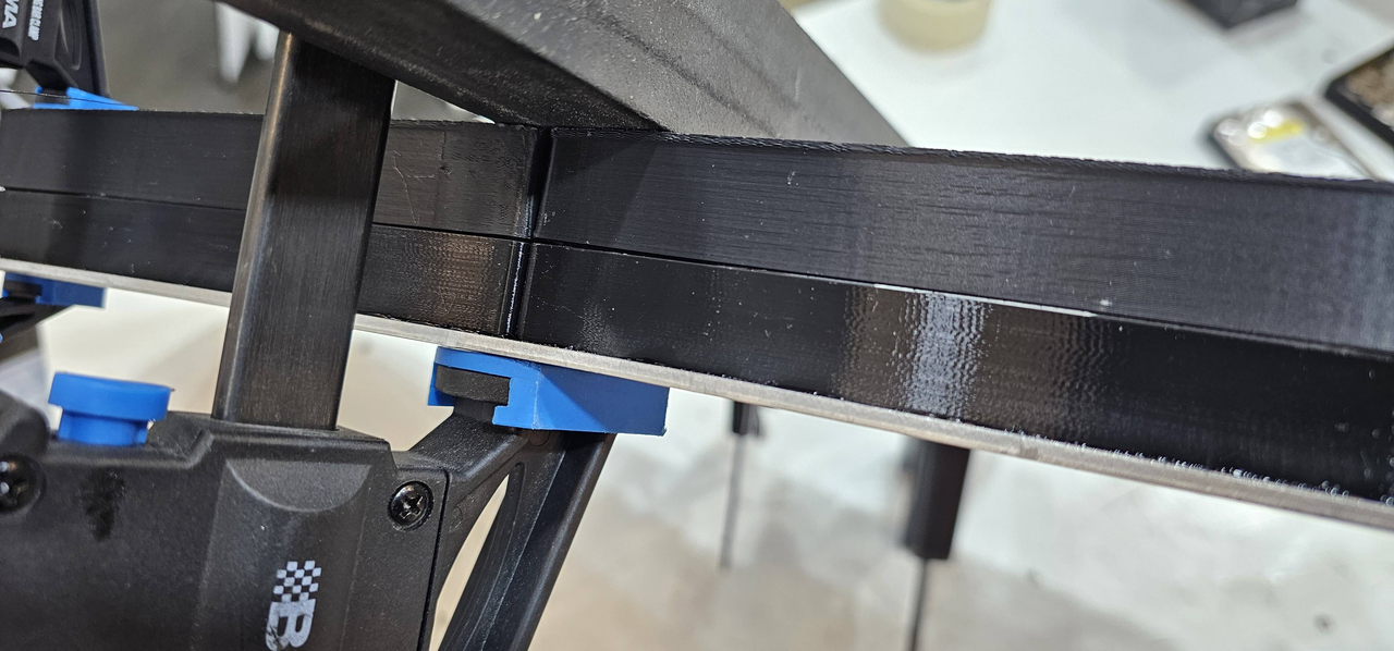

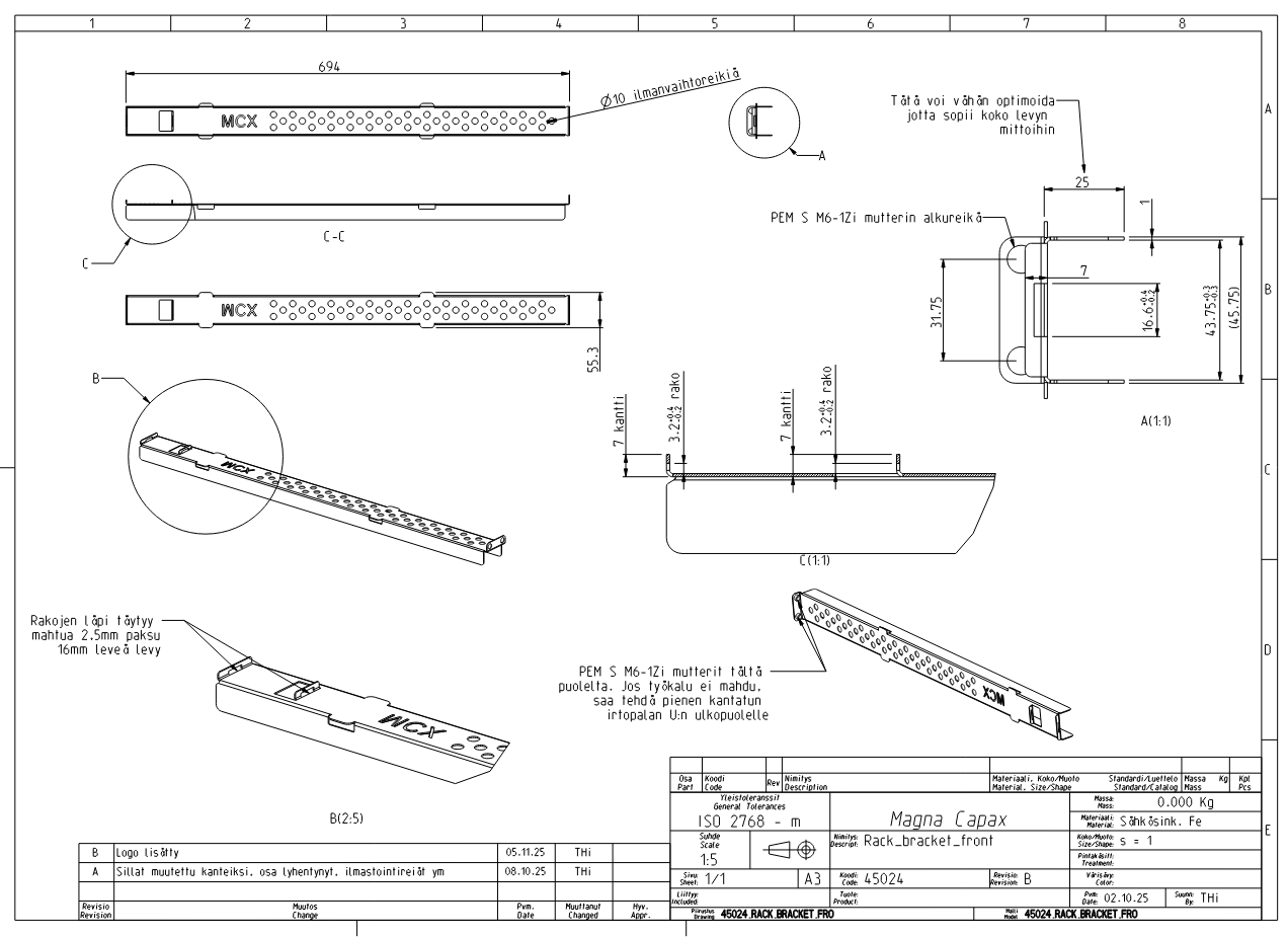

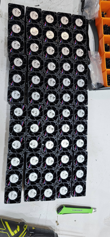

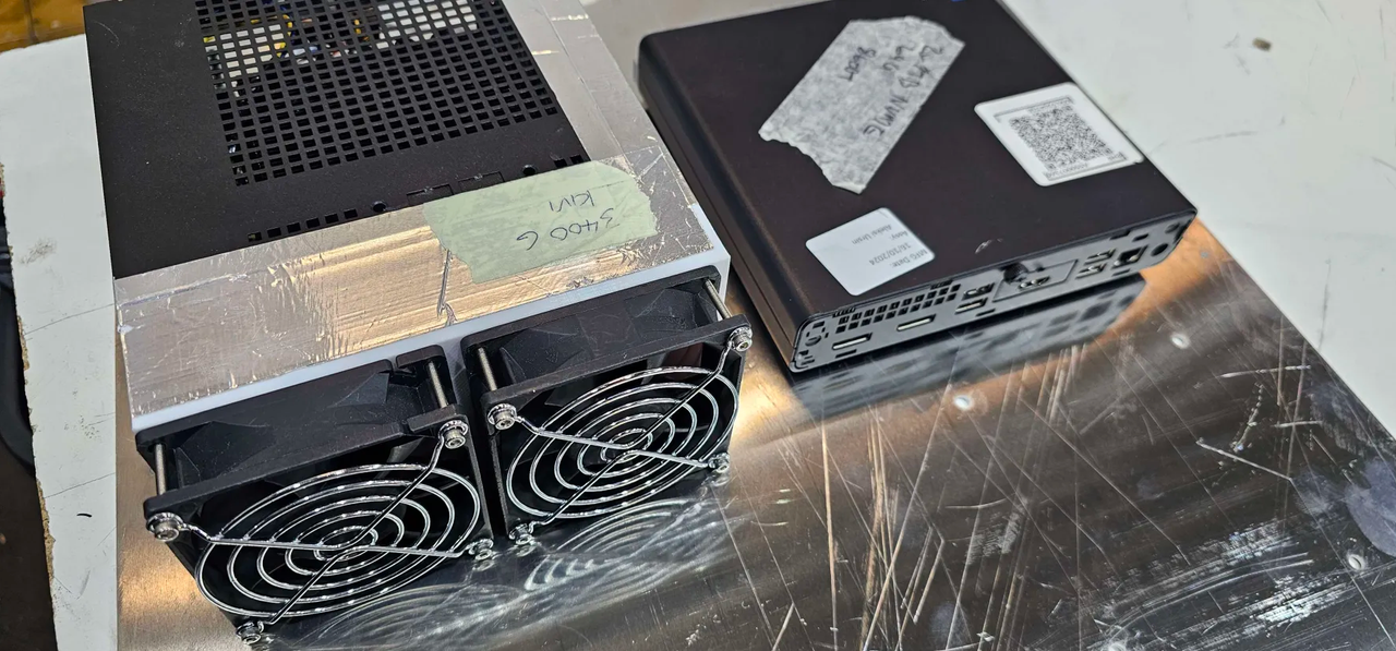

New fan module tested, and built a few. One shot design finish, no prototypes in between. Rare, straight into production.
Built a few of these fire breathers!
They work as exhaust so can be blowing 50-60C air out all day long.

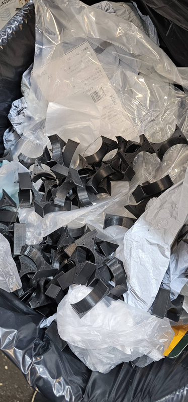

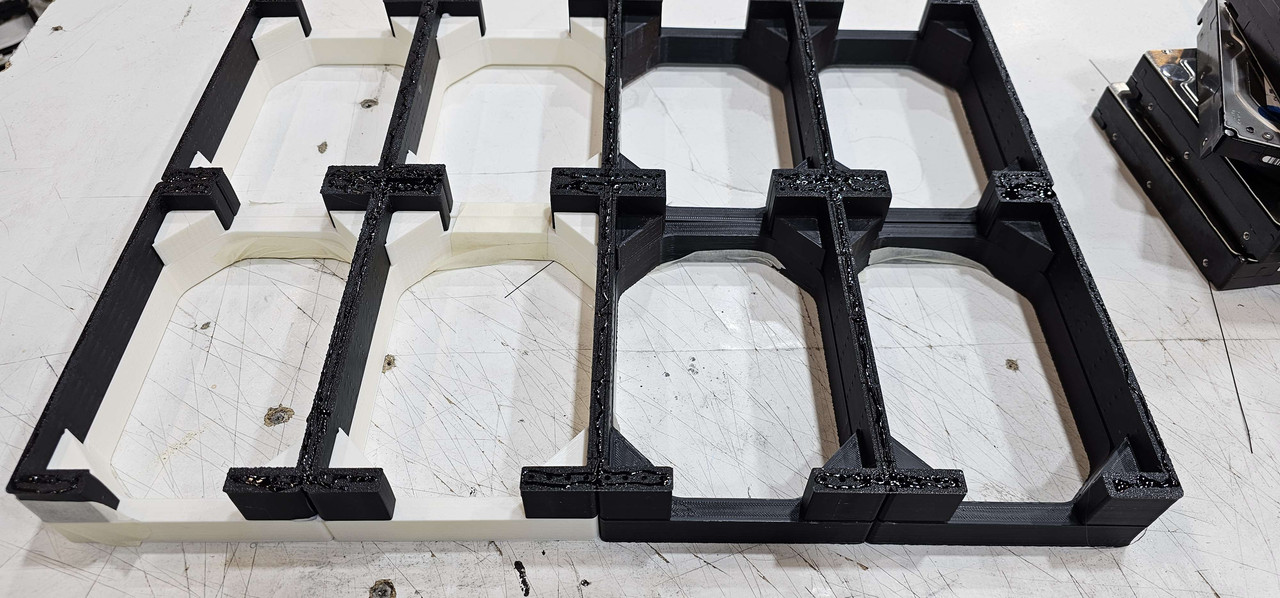

... and in the trash goes the old design parts just printed
Old was multipart, wasted space etc. This new design took 15minutes, is tighter, stronger and faster to assemble, we have now standardized on 3 fans on each mPlate.

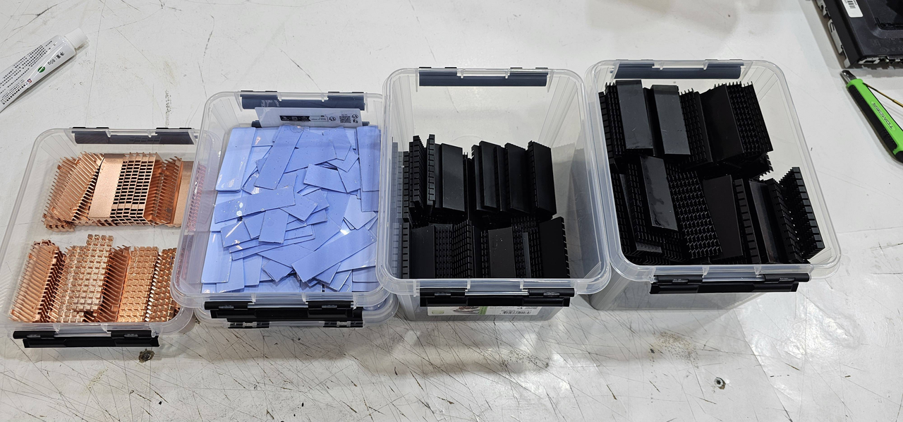

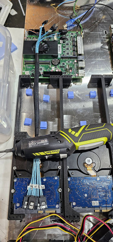

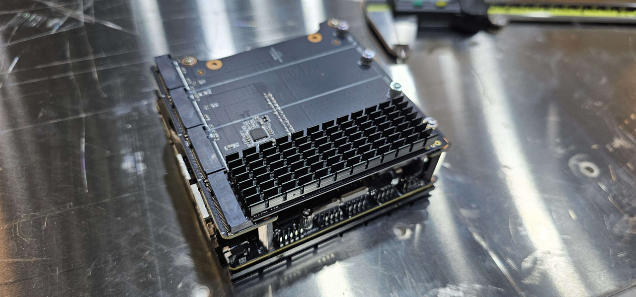

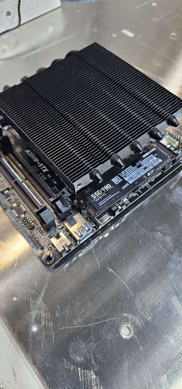

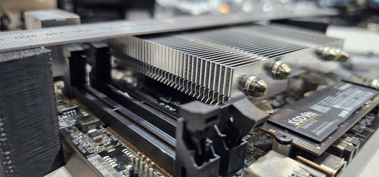

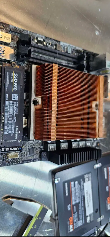

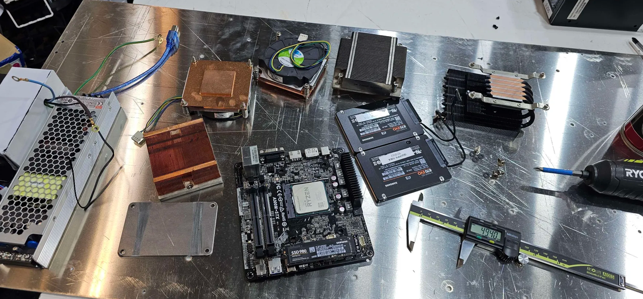

Ah! Heatsink found for the AsRock A300/X300 Ryzen minis which fits. Didn't bother getting some custom brackets for Opteron G34 heatsinks (we have hundreds) and bought these, just 20-30$ a piece. Some of ours already have this low.

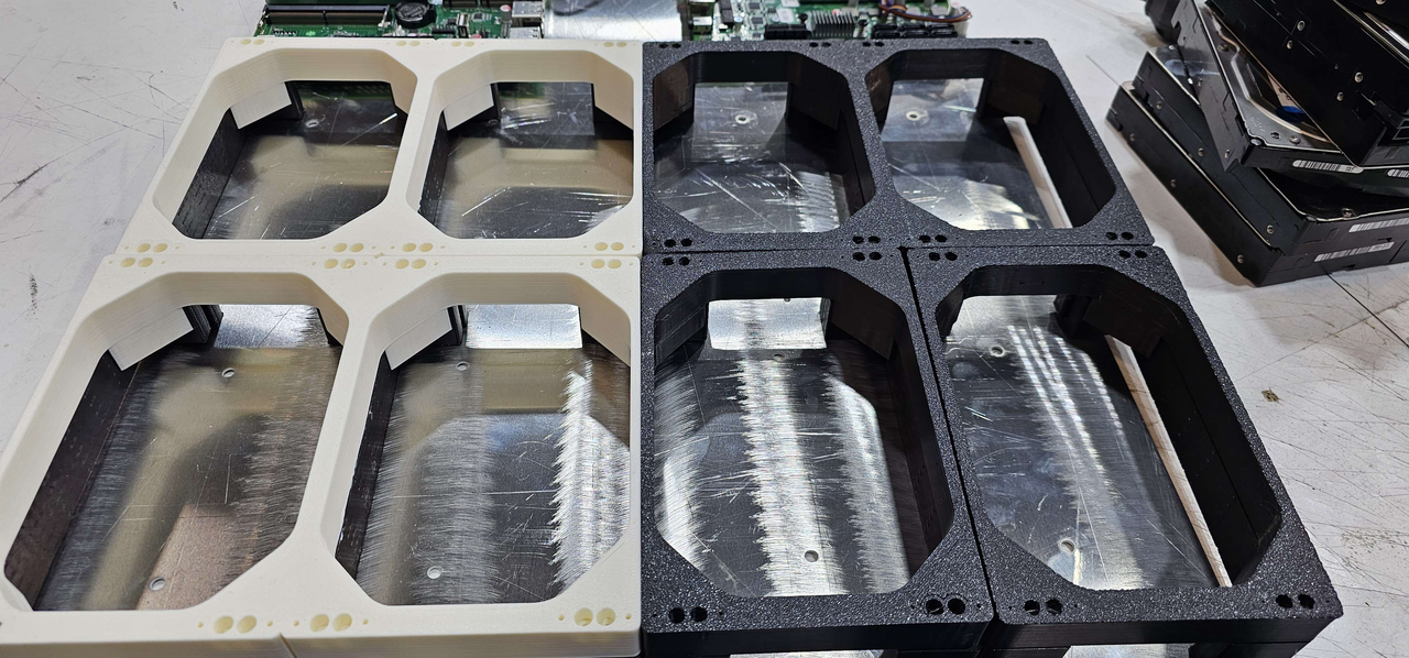

This enables us to put these on the mPlates.
Not certain what configs we will make, but we will probably do all of them with same config and buy new CPUs for them to make them identical with each other, or a split of A300s with 3000G and X300s with 5600G.

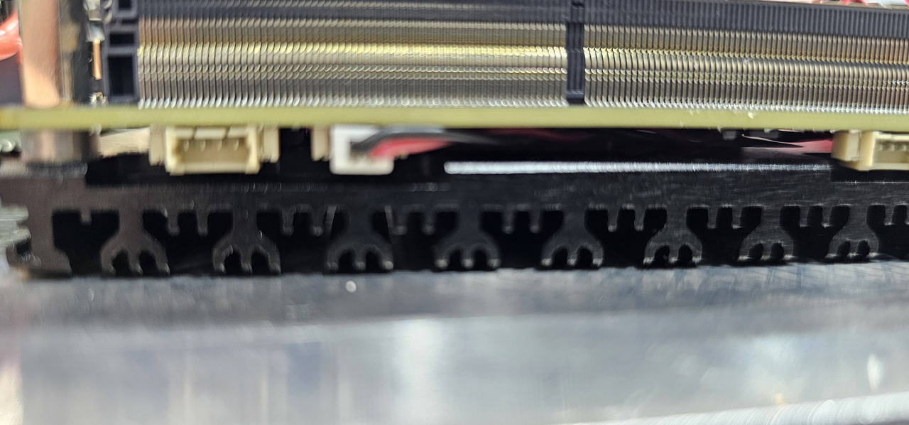

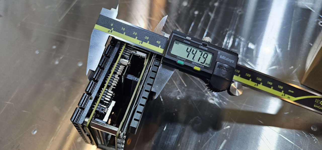

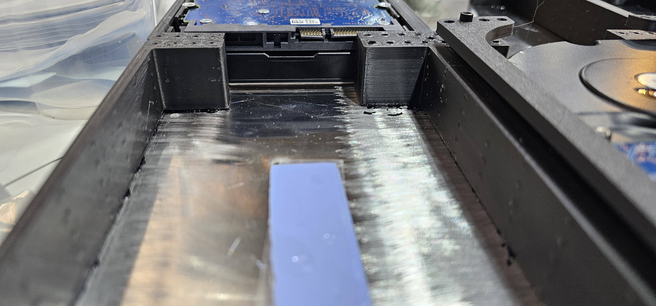

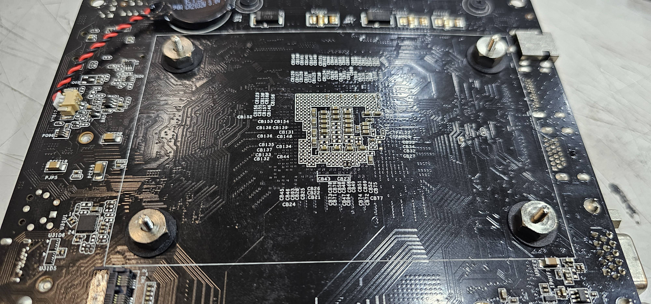

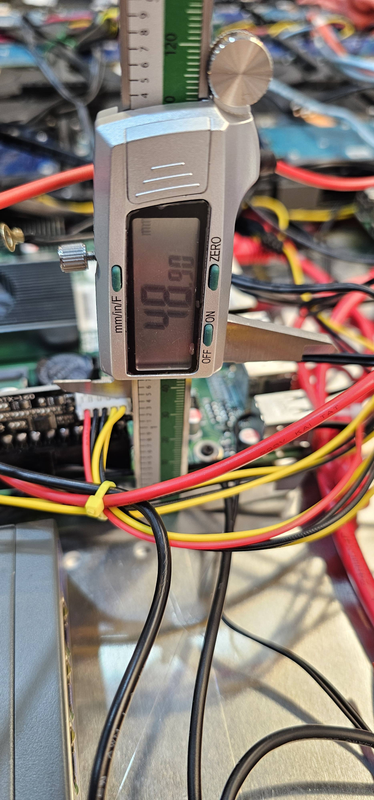

Don't mind the IO is too high, the motherboard sits an extra 4mm too high, have to take angle grinder to the heatsink mount threads to shave of the extra 4mm. Just a few second job.
This is why it takes 2 months to deliver!

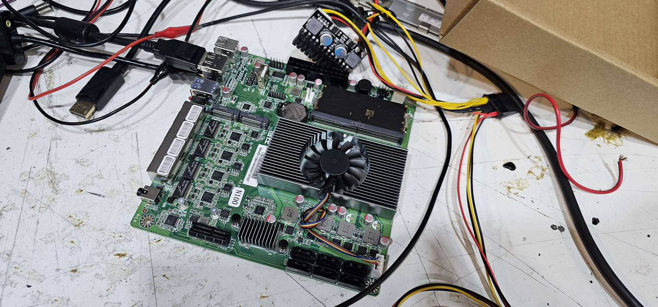

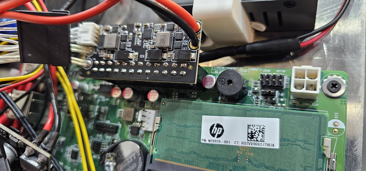

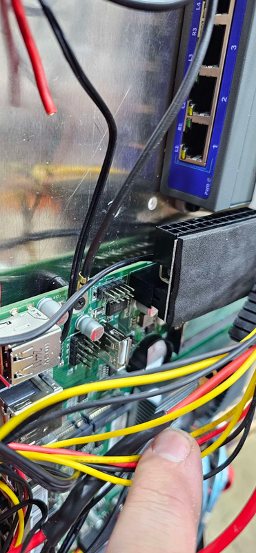

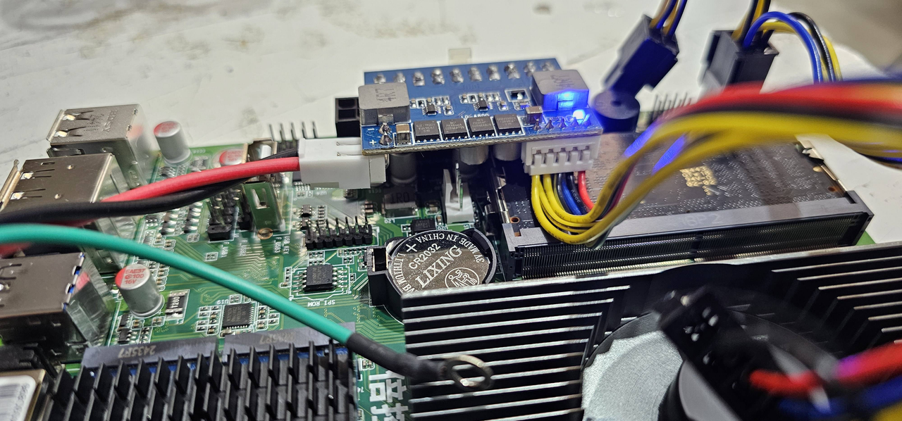

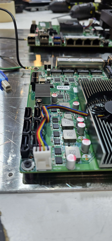

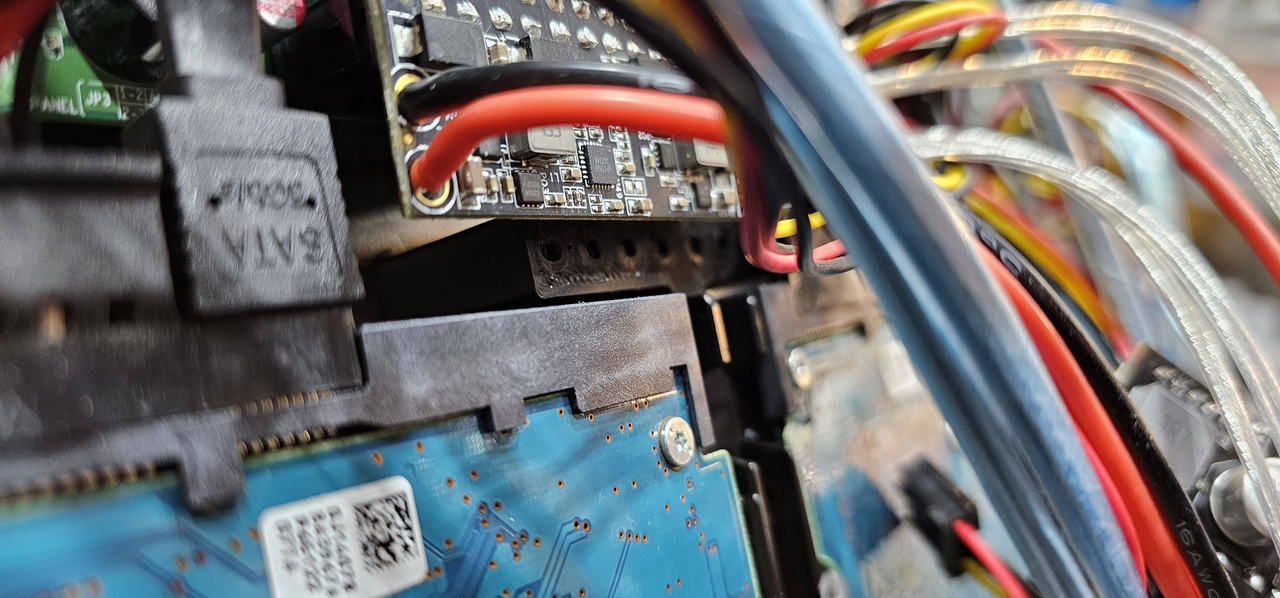

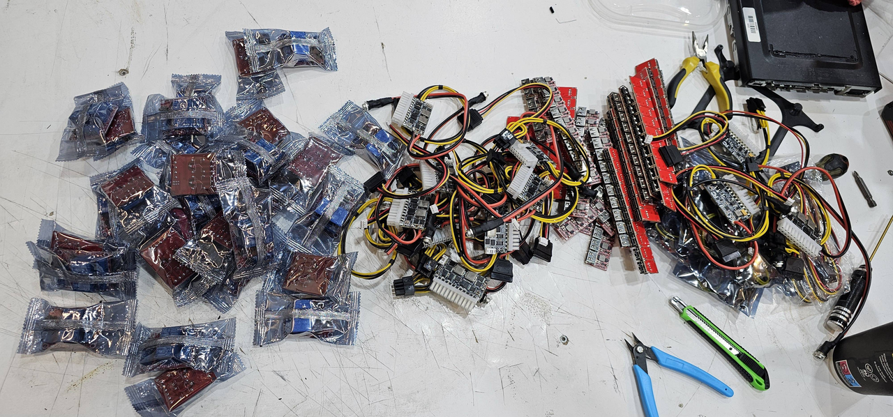

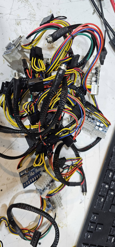

Got the 90 degree adapters, they are wong way, not tall enough etc. Hits the switch, and on other side the HDDs.
RGeek makes some picoPSU 90 degree angle which looks like it is on the other way around, contacted them.
Also we have some ATX 24pin extension cables (variety) coming, variety of tiny DC PSUs etc. to test out and pick the best version out of.
This will get solved, but it just takes time!

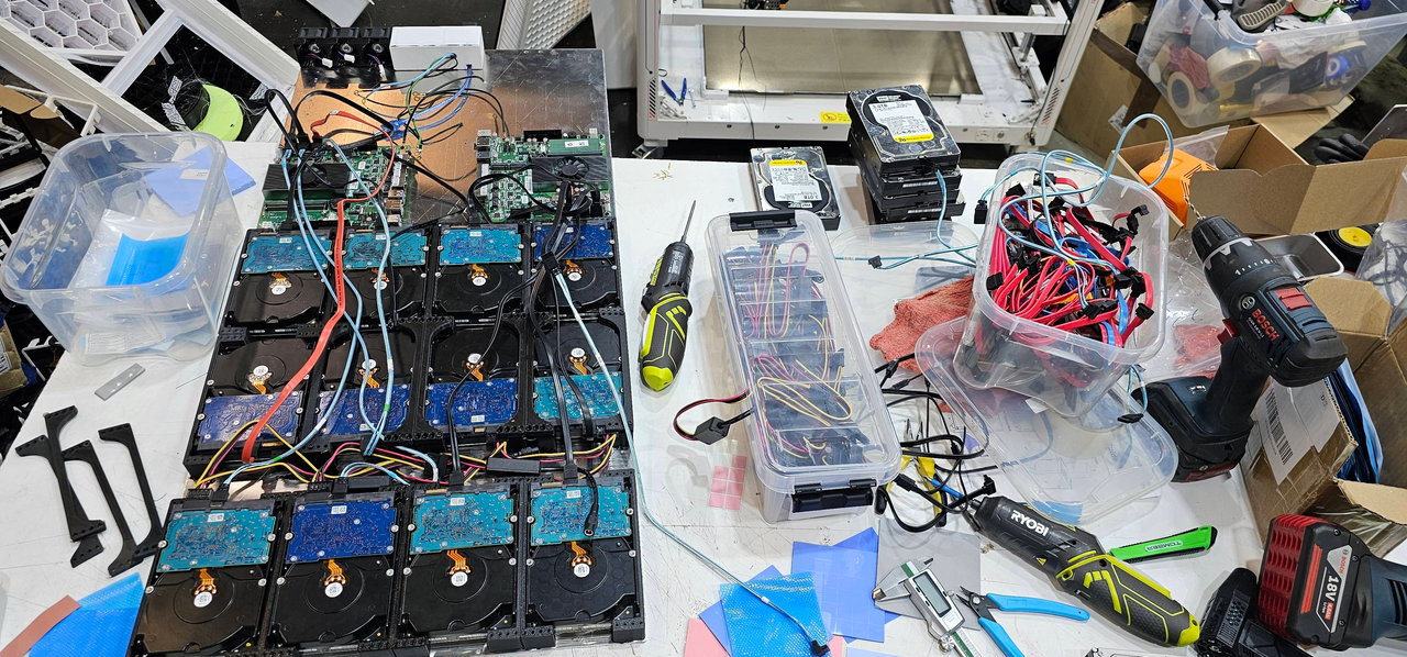

Mass Production!

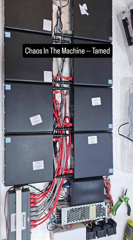

Prepped 5 mPlates with nodes in one go.
and Tamed The Chaos!
these beasts will be racked within 2 weeks or so. We are just now prepping another rack in our Helsinki DC (The Battlefield Zone 1), it will be mainly for this NAS version tho.

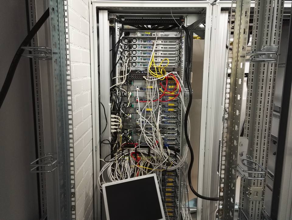

9 years ago when moving into the current Helsinki DC
If i recall right we moved that rack from previous DC within 3 to 4 hrs. That was fast derack, re-rack, wiring job.
rgeek makes almost the perfect picopsu for this use: https://www.rgeek.com/portfolio-item/rgeek-pico-dc-psu-rp-200p-n-dc-12v-24pin-power-supply-module/
Just needs to be turned 90degrees, cable lenghts etc.
We are ordering a test batch of their 90degree picopsu: https://www.rgeek.com/portfolio-item/rgeek-pico-dc-psu-rp-90pt-dc-12v-20pin-power-supply-module/

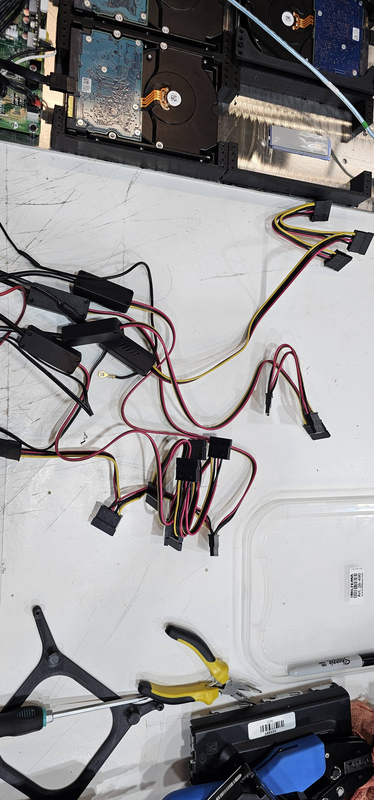

We still have to handsolder power wiring loom for the HDDs on this initial batch, but in talks with rgeek for customized version. the minimum order quantity right now is a bit high tho, but at least we have that option on the table.
We just might bite the bullet tho and just order the custom picopsus ... Just that it will be like 95% more units than we envision needing in a few years tho. Then again, we would have a verified model to use any mITX board easily, with HDDs or without, in a wider power band (think Zen5 mITX ....)
Decisions decisions. Hardware development ain't easy.

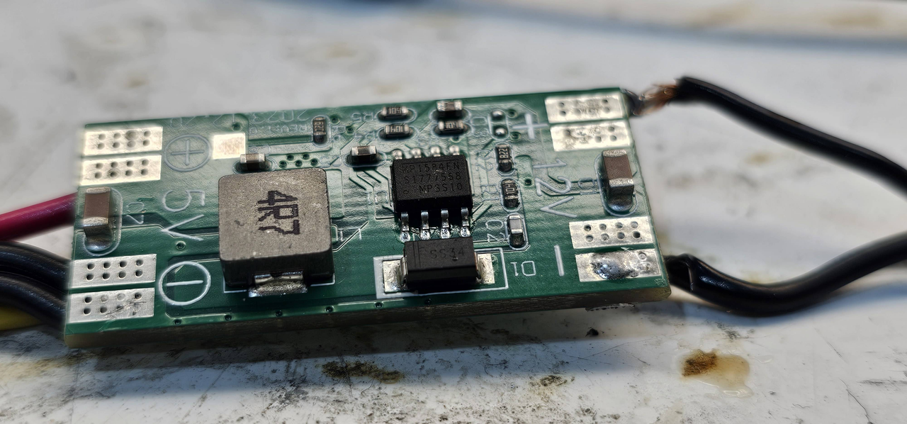

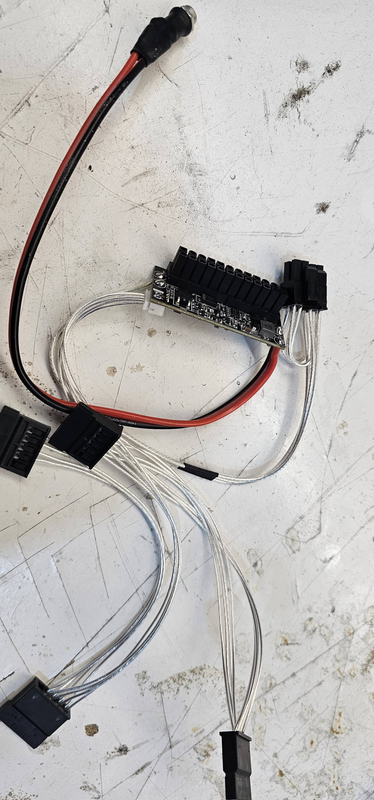

NAS Power solution is here!
I think we will go with these, 3 arrived now from this manufacturer, will be ordering more.
We also made test order of 10 of 90 degree to RGEEK and have discussed about customized version, Qty 500 MOQ so ... That's a bit more than we need in a few years.
Will be testing next week and hopefully we can deliver first units within 2 weeks!
This was the reason for 2 month preorder, it's still cutting a bit close to the June 1st, even tho we had everything in stock by our estimate and belief, but turns out components didn't match.
This is why HW development is damn slow. Months just fly by when you don't get the exact matches.

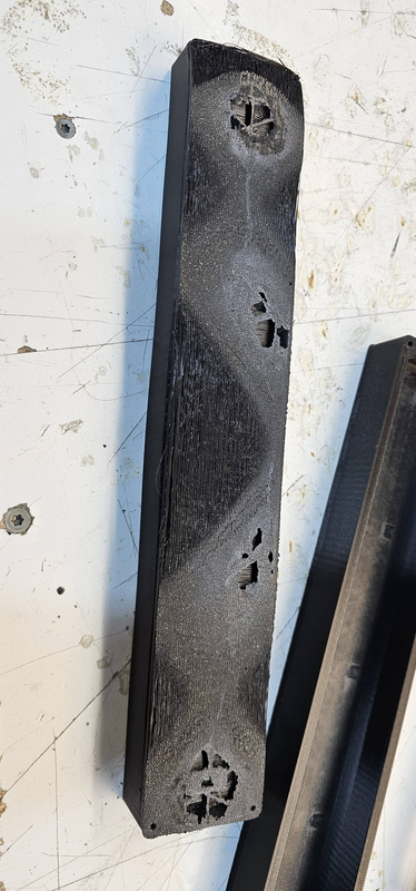

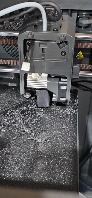

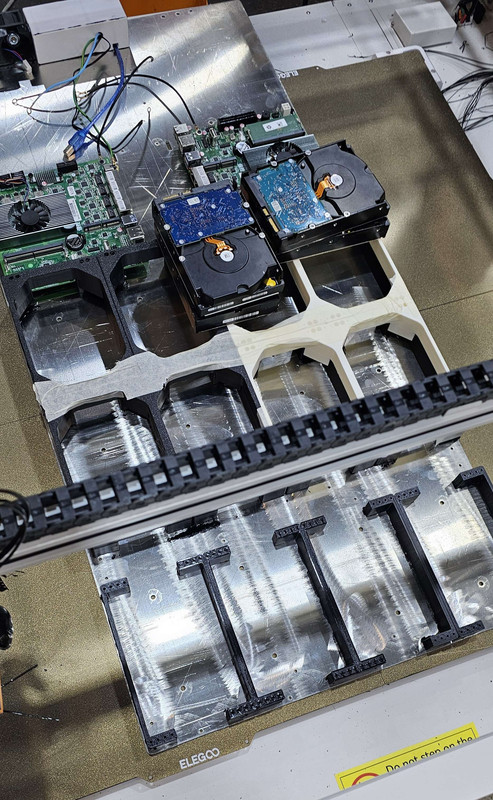

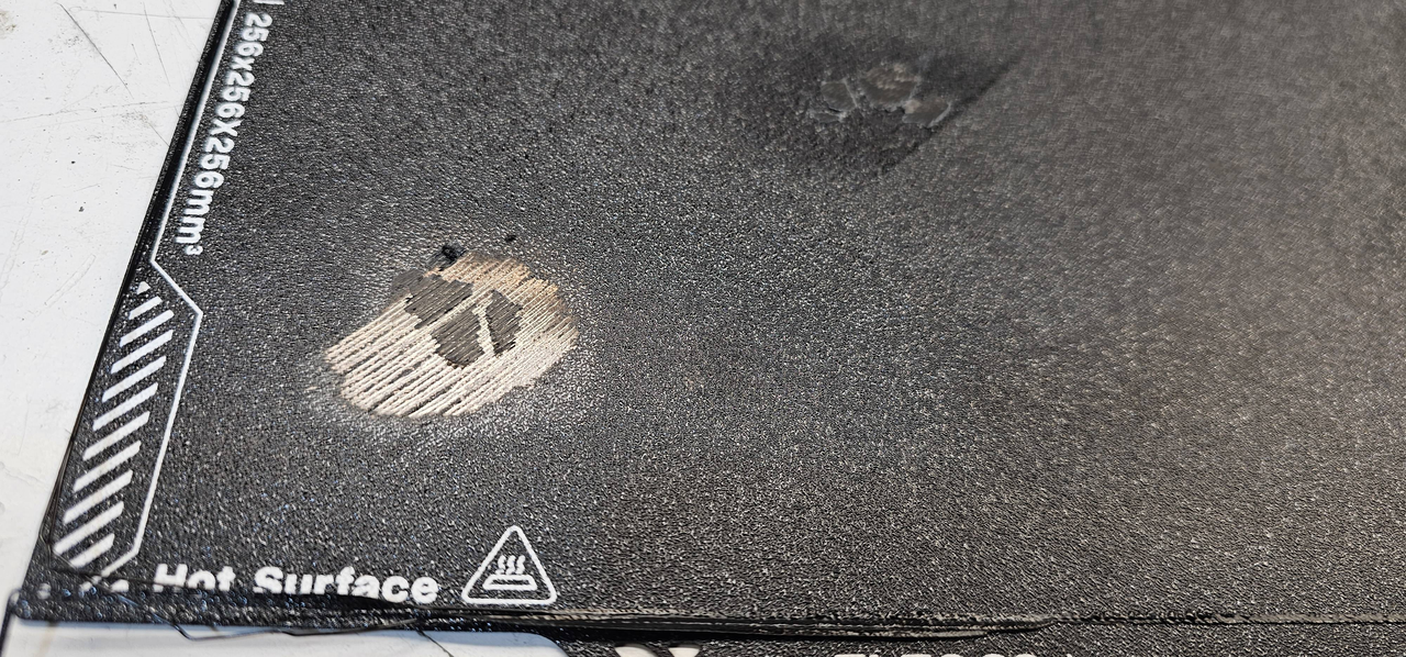

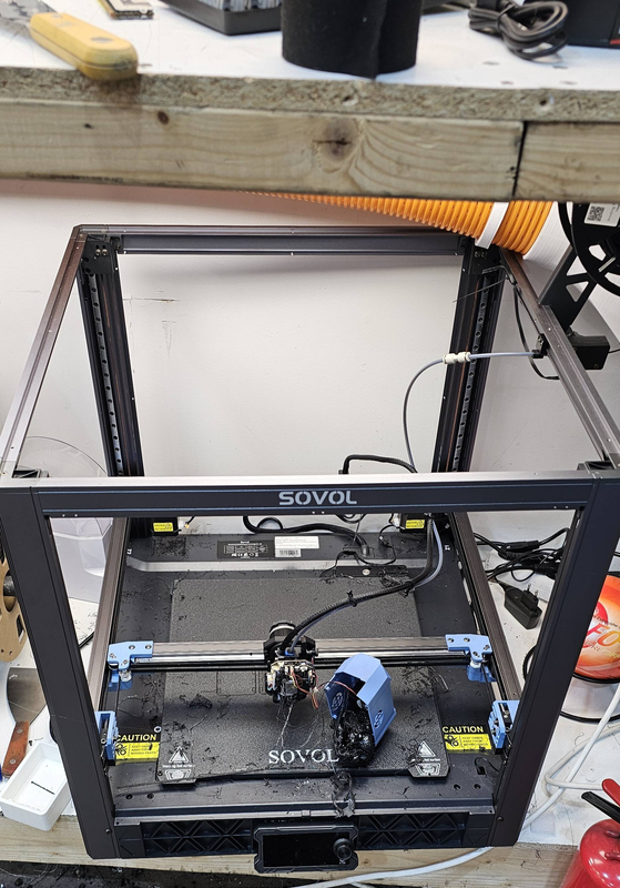

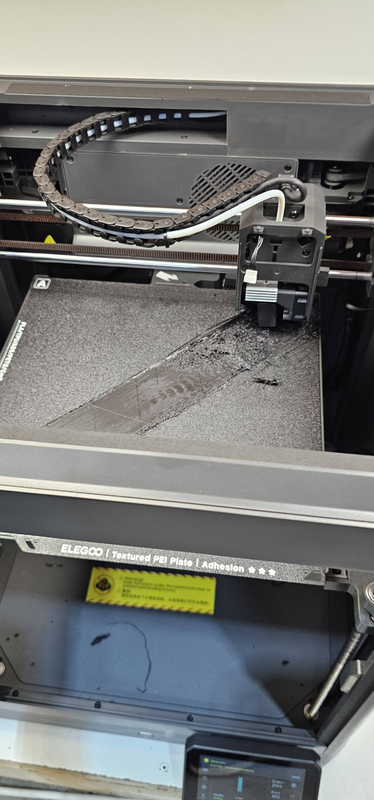

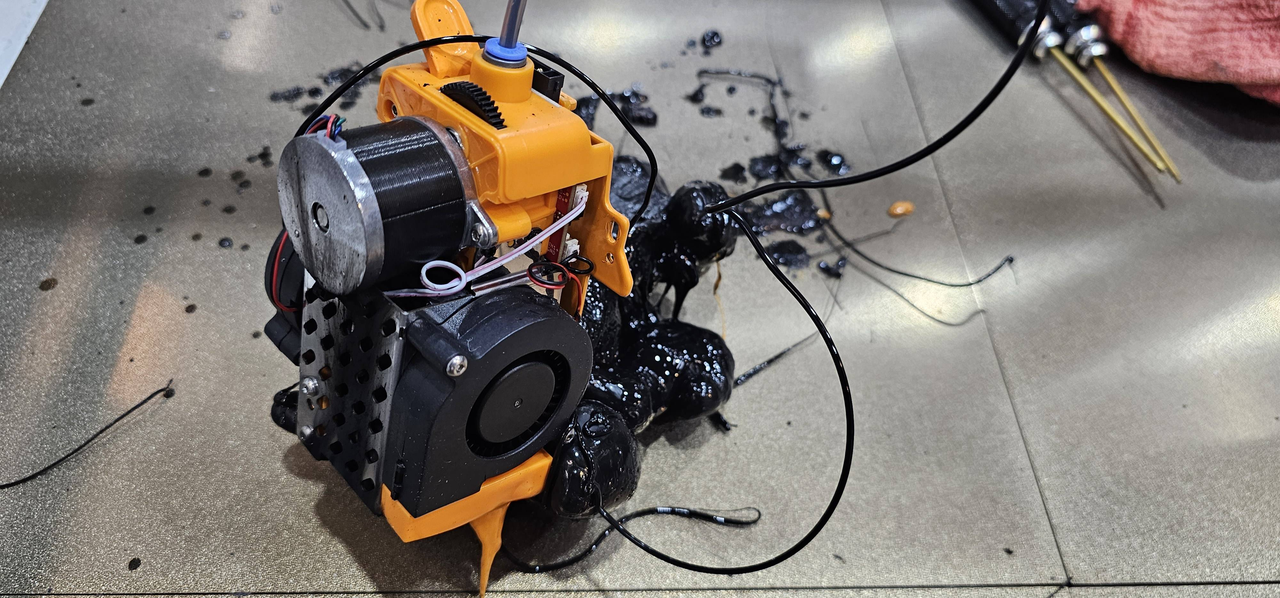

meanwhile, today this Elegoo Centauri Carbon hotend bit the dust ... again. Had some serious leveling issues, and this despite preheating / heatsoak.
Some bugs in firmware, this was it's idea of straight line, Z level compensation ....
Bed plate ruined too
Well that is an unexpected tight spot.
No idea yet if this means anything, we have to check more stuff, inventories etc. but stuff like this happens.

That SATA cable height has to be solved, some more testing needs to be done, and additional 90degree PSUs have not arrived yet. And we'd like to stress test internally a little bit before delivery too, or should we add second 3x FAN module on these units.

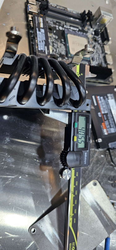

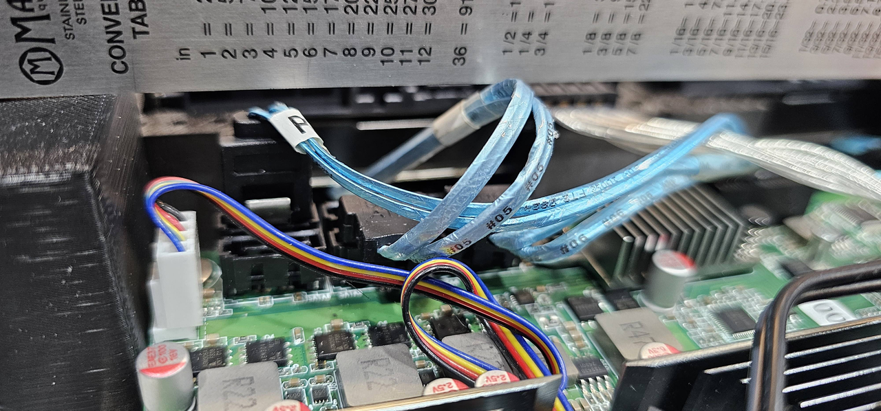

Wiring on these is total PITA. Looking to outsource to another engineer familiar in this kind to build custom backplanes for us. Even if they end up costing say 150€ per mPlate (12x 3.5" on this 2x mITX motherboard setup) it is worth it at a hunch. We can integrate buck conversion etc. into it.
We'll manually wire these first few units, and then consider the custom PCB/Backplane design. Considering the number we need to build these (hundreds to thousands), it's not an unacceptable cost.
Clearance resolved
Already bought angled cables too etc. but also resolved it this way too.

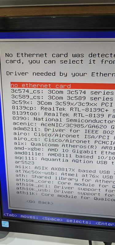

Software Issues; Intel i226V drivers
Also custom templating has to be finished before delivery because of this + UEFI. Lots of SW development.
Progress Update
Got the UEFI boot with Intel i226-v + deployment scripts proof of concept done finally.
It's now finetuning and making a bunch of distro templates.
Debian 12 Netinst doesn't even have working i226-v driver, so templating/imaging system is the only way to get these to work. Interesting.
We began with custom "mcxRescue" which will host all those scripts and allow you to deploy ~any image to a server.
but step by step. It'll get done. We'll deploy it for all nodes as soon as possible, it will replace the old "SysRescueCD" we've been using through NOC-PS.

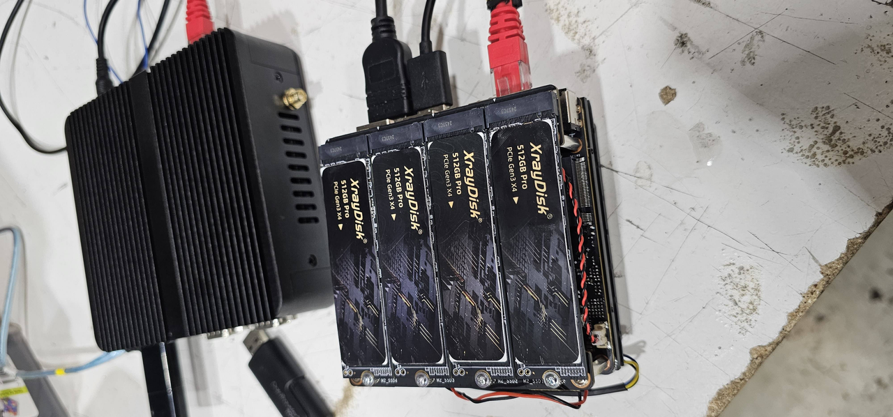

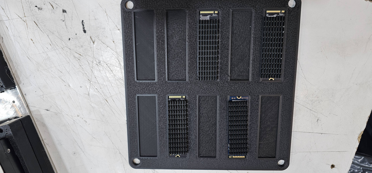

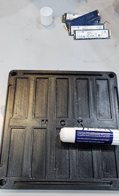

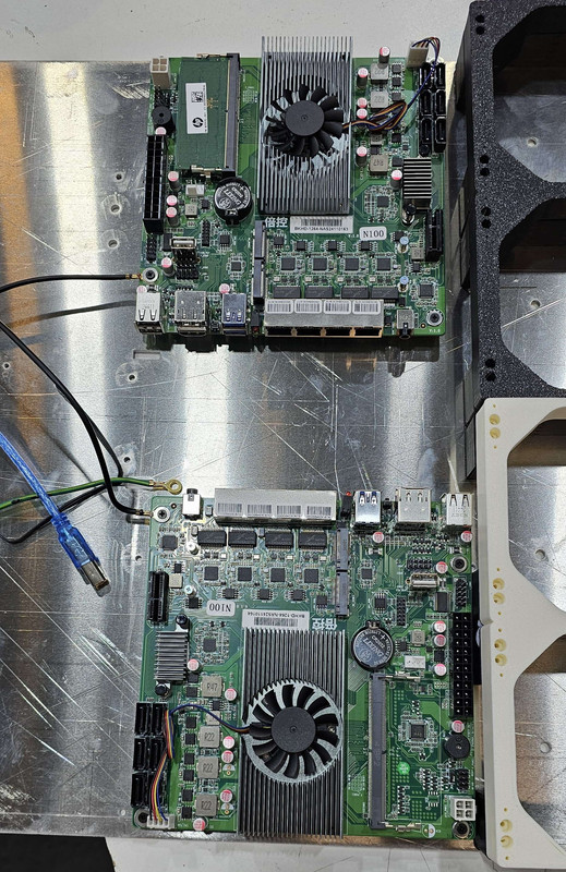

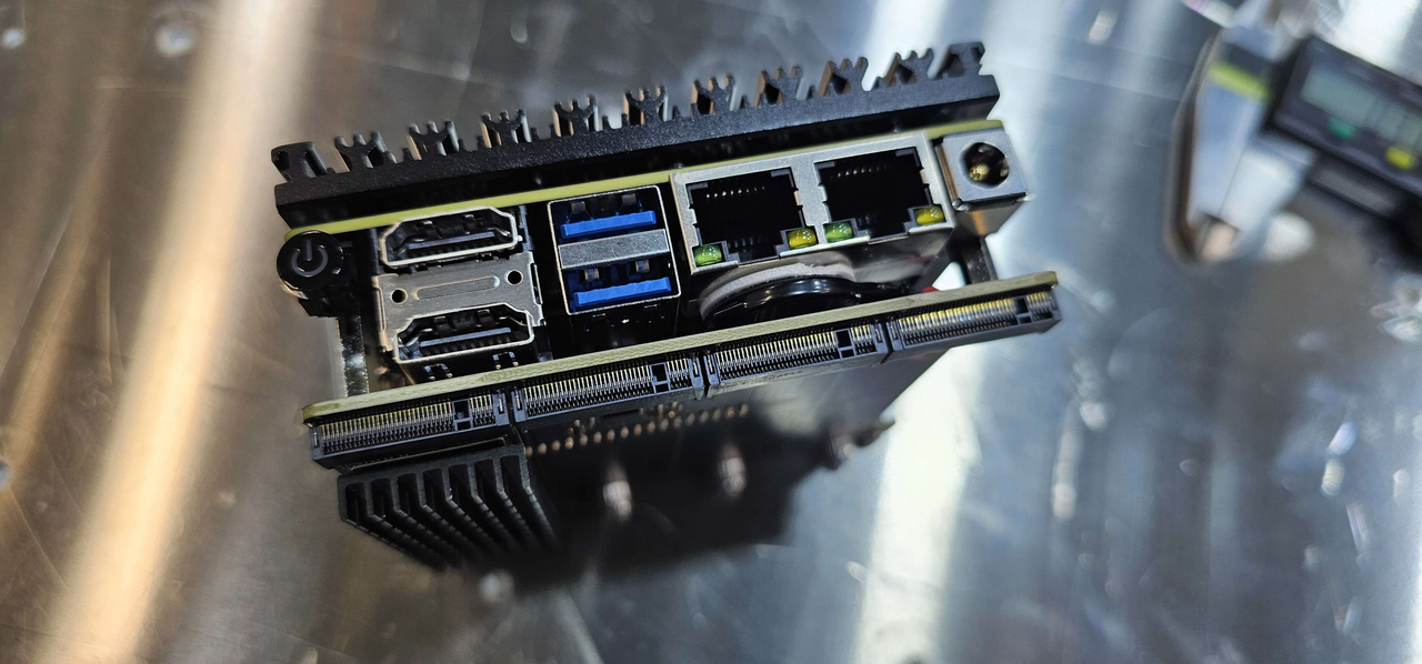

NAS mPlate update; 2x mITX 6xHDD mobos + 2x 100x100 NUCs with ~72mm mounting pattern prototyping right now.
These particular NUCs house 4xNVMe (tho x1 per NVMe or x4 shared amongst them)
slight cooling issue, not a big deal tho. and 0.50mm thermal pads, the full 100x100 sheet cannot be easily opened, so might have to go with messy solution (thermal paste). 0.10-0.15mm gap between mPlate and heatsink.

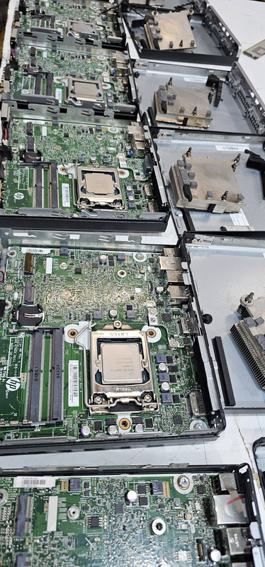

Lovely upcycling of electronic waste.

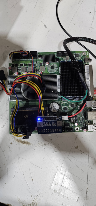

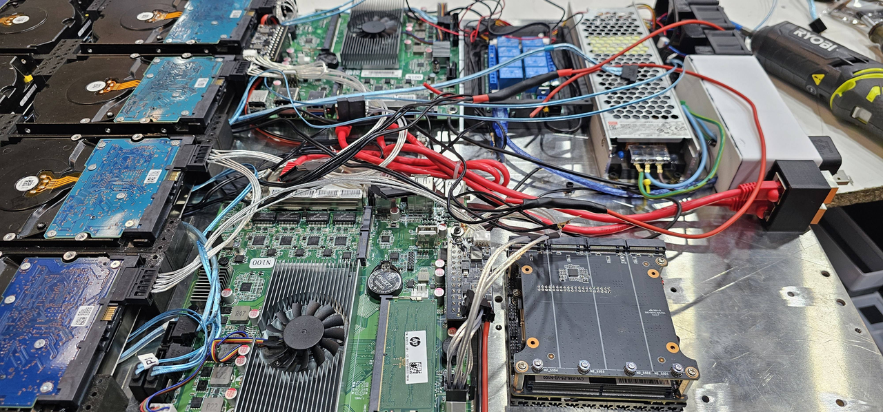

First NAS mPlate has booted up with the correct parts and hardware. Bursted 308W during spin up, then settled into the 140W range when idle.
This is without the NVMes plus planned 2x NVMe NAS units installed. So the PSU might not be sufficient for the bootup process.
Many tests remain to be done, and then we'll complete the first batch (8x NAS nodes / 4x mPlates) for delivery.
