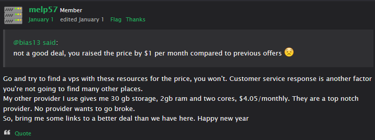

    @melp57 care to comment?
    for reference:
    I found the prospective customer service response over there was nothing like I find many other places. :D :D :D A lazy and uninformed provider as well as a shill butting in to each enquiry.
