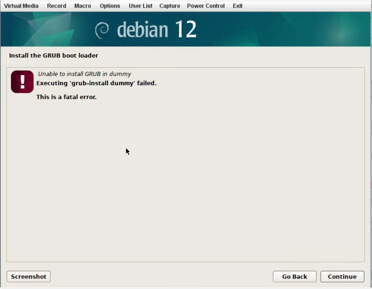

This time it proceeded, installed the base system & others on, while installing GRUB, it showed the below error:

I tried to follow the same configuration in both Raid-1 & Raid-10 but the above error persists.
Anyone have Debian 12 installed with 4 NVMe Drives in Raid-10 formation ? Or, if anyone can explain the error of above screenshot. Point to be noted, there is no data in those partition, no other OS installed, freshly formatted.

    But, making it Raid-1 (the EFI Partition) throws the same error as the screenshot of original post.

    We have had same issue with raid1, ended up making a non raid drive/volume 2G for efi, and the rest for raid1. Only in this way then the grub-dumy error was gone.
    You can only raid1 an efi partition by using 1.0 metadata on an unpartitioned disk. It is a bit of a hack and not useful to you here as it won’t let you also have raid10. Use separate non-raid partitions for efi

    UEFI lacks support for software RAID. You can hack around with mdadm 1.0 but you may encounter issue under certain circumstances.
    You can sync the redundant EFI partions with a Grub Hook as a probably better workaround.
    https://wiki.debian.org/UEFI#RAID_for_the_EFI_System_Partition
