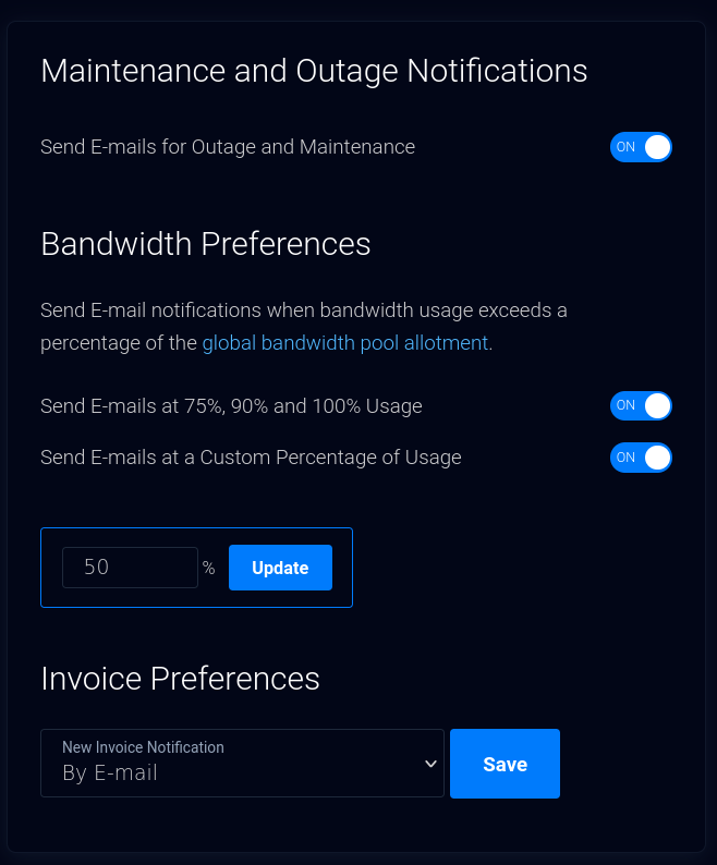

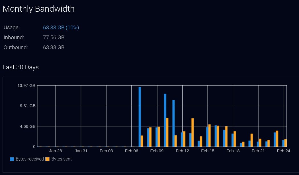

Also, here are some of the bandwidth-related graphs and information from the Vultr account, so you can see how it's working.
