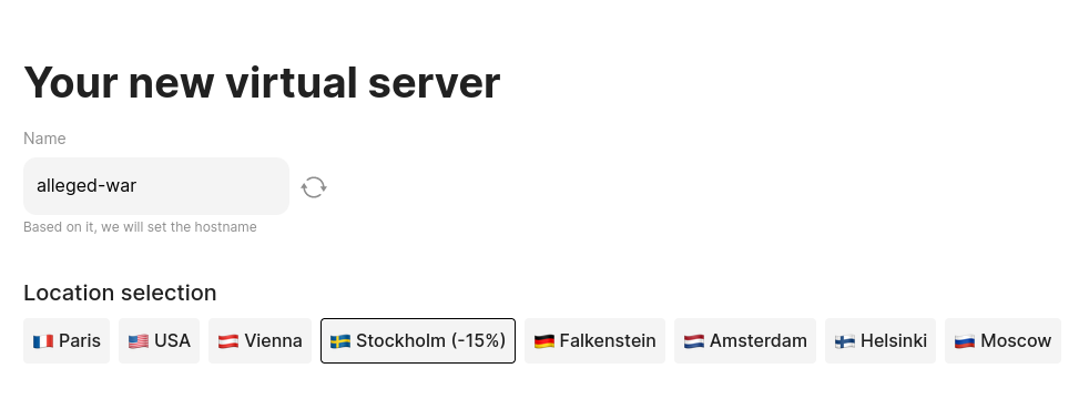

Promo Offer in stock right now.
They set limits, only one per account.
