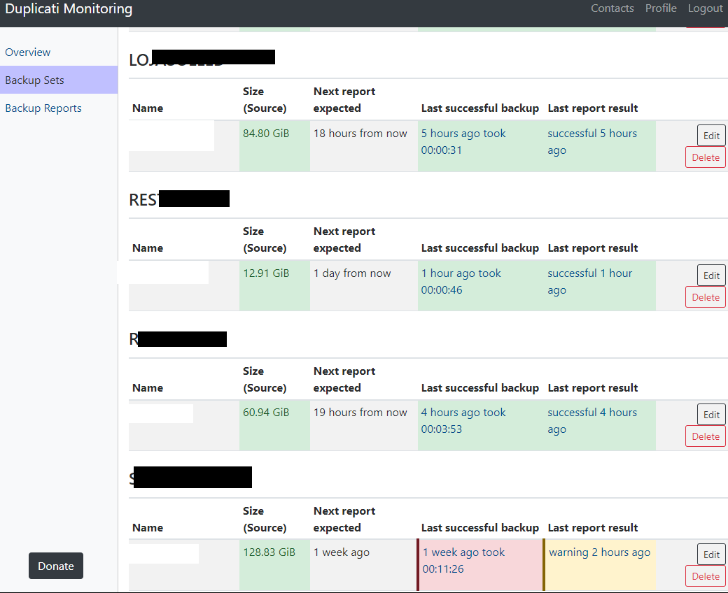

  • I recommend Restic as it's very easy to use and battle tested. Someone above recommended Duplicati and Kopia.... two of the least reliable backup programs out there :D (Do your research)
    Yes I know restic. Very reliable
    I'll try borgmatic + borgWarehouse.
    I haven't had time to get into it yet, but it looks promising
