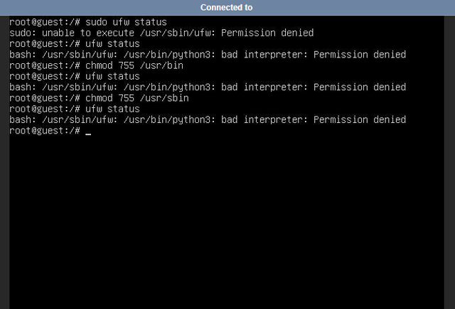

Just a small issue (maybe),
After I log into the web console, I can't run all commands inside the /usr/sbin/* directory.
For example,
When I run "sudo ufw status"
It says something like "sudo: unable to execute /usr/sbin/ufw: Permission denied"
But when I check my account (with "whoami" command), I was a "root" user.
Am I missing something?
you could try
" chmod 755 /usr/bin "
Seems like it's not taking effect,
should I reboot the machine?
it seems like your going in the right direction, id try the same command but with a -R after chmod to make it recursive.
chmod -R 755 /usr/bin
You should do "su -" first, to inherit proper shell env variables, but again, follow any of the proper manuals about the right way to it, you won't find anything missing there, and you will just consume our time taking you step by step.
