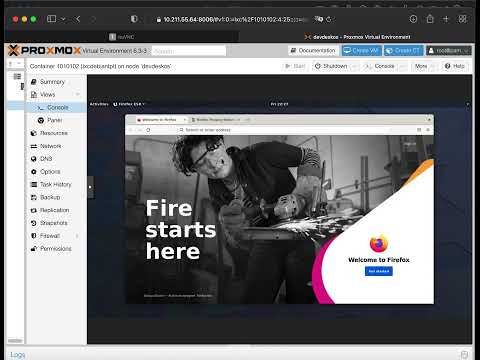

demo:
(this is a demo installed onto a oracle freetier arm 2c16g)
how to play:
  • install devdeskos : an integrated proxmox project fork at github.com/minlearn/onekeydevdesk
    (below works under a debian based linux os , you can track the installing process in a novnc view opened at http://yourip80 while it happens ):
    wget -qO- 1keydd.com/inst.sh|bash -s - -t devdeskosfull
  • when logged in:
    (use root/1keydd to login at https://ip:8006 firstly)
    1,start 1010102, click "console",wait till it hints "password check error"
    2,click "datacenter" (left column in the UI) ,click syslog (middle column in the UI)
    find a log entry,which is in the form of:
    "x11vnc -storepasswd PVEVNC:642A9400..........4MAG1wA== /etc/x11vnc.pwd"
    double click and copy it
    open 1010102 xtermjs (upper right corner of the UI) ,
    login with root/1keydd,paste and let it be executed。
    3,again click 1010102 "console",vnc now works and connected。and you can play it now
enjoy yourself and dont forget to star this github repo if you would like to:
https://github.com/minlearn/onekeydevdesk
