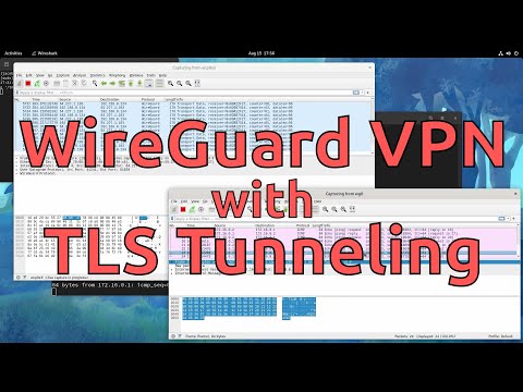

Better yet fully wrap your VPN in HTTPS - sTunnel comes to mind, but I haven't used it in a while.
You can wrap WireGuard in sTunnel
