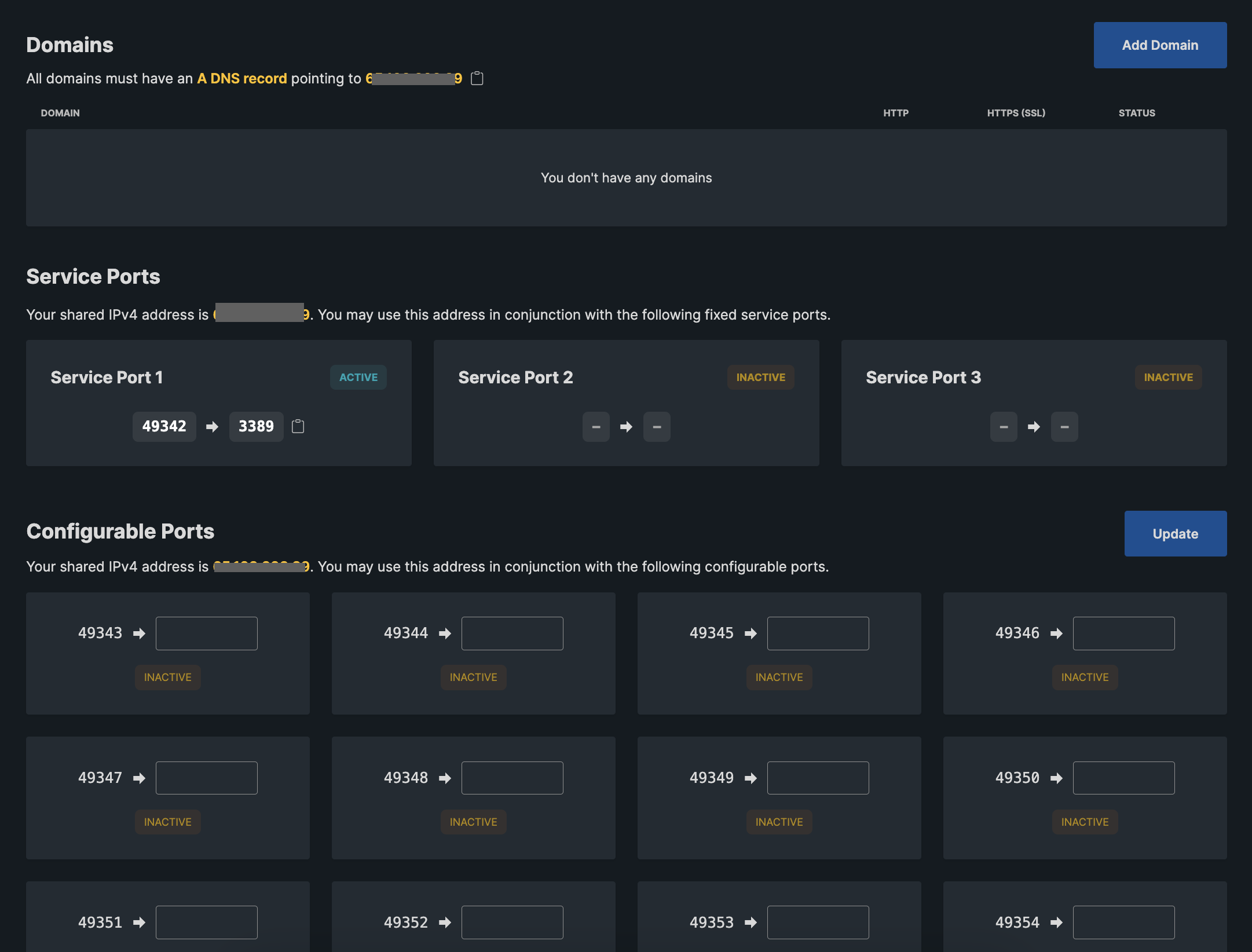

  • VirtFusionVirtFusion Member
    edited February 2023
    Like mentioned above, you could use v4 NAT and/or subnet the v6 /64 supplied with a Hetzner server. They also offer v6 /56 subnets with a 15 euro setup fee.
    VirtFusion supports NAT + IPv6 in the current testing build.
    Install a hypervisor as normal:
    https://docs.virtfusion.com/2.0/installation/hypervisor
    But stop at the network configuration.
    Configure the network:
    https://docs.virtfusion.com/2.0/guides/nat-setup
    Update to the testing branch:
    vfcli-ctrl update-testing
    Once it's set up, the rest is done within the panel.
    You can manage port and domain forwarding on a per VM basis.
    You'll even receive an email with all the relevant connection info. RDP etc...
