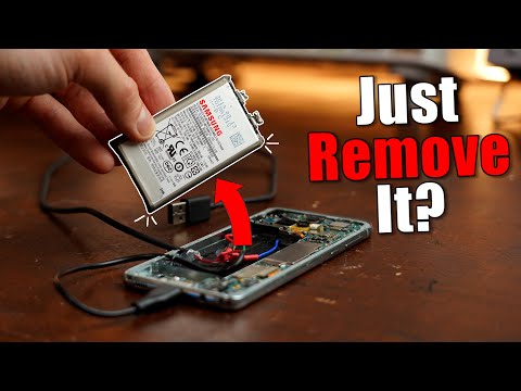

  • Battery is the main issue for old phones. They are not meant to be constantly on charge and I'm not sure how many support current passthrough. If you manage to remove the battery and it turns on then it should be fine, thermals won't be great but at least you don't have a possible 💣 threat in your house. I was toying around the idea of using my old phone as a tailscale exit node at home but haven't gotten around removing the battery yet.

  • Removing the battery looks possible.
    edited October 2022
    Many phones won't boot if the battery is absent.
    PinePhone can start without battery but there would be no WiFi or LTE.
    It may be possible to pretend there's a battery by connecting your power supply to the battery port instead of the charging port.

  • If you want to use a phone without battery depending on model you might be able to simply connect power supply to battery port but if it didn't work you can emulate a battery connector.
    For 3 pin connectors a simple schematic like this can work : https://www.electroschematics.com/mobile-phone-battery-emulator/
    Also BTemp pin in 4 pin connectors is not important and most phones will run without it being connected.
