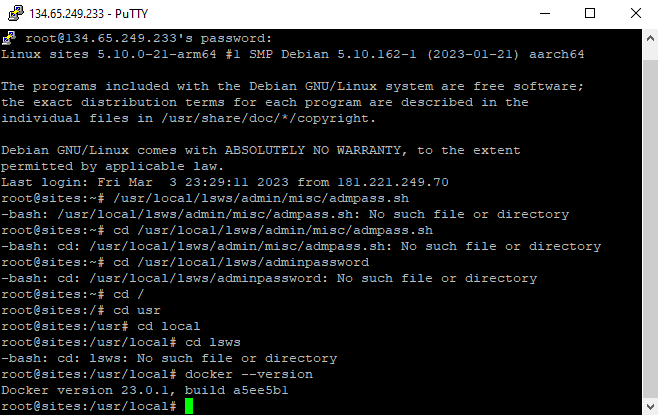

    @FatGrizzly thanks for guide.. can you tell me how to compile and enable php7.4 extensions like curl, memcached, imap, opcache and imagick with litespeed inbuild compile php system at 7080 port.

    I Tried but no success can you elaborate. I want to enable opcache and all these settings.
    https://ibb.co/zFBVSnK
