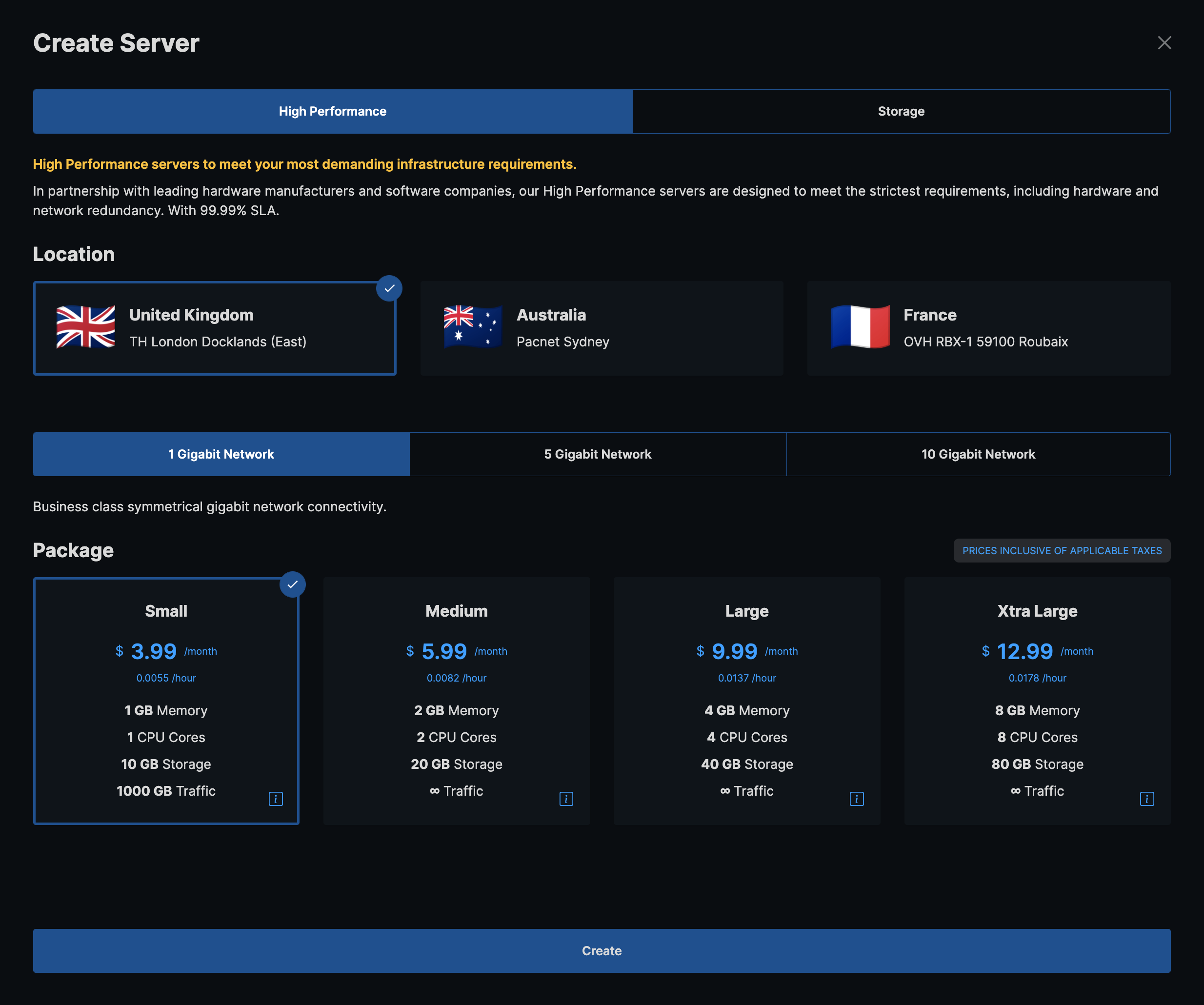

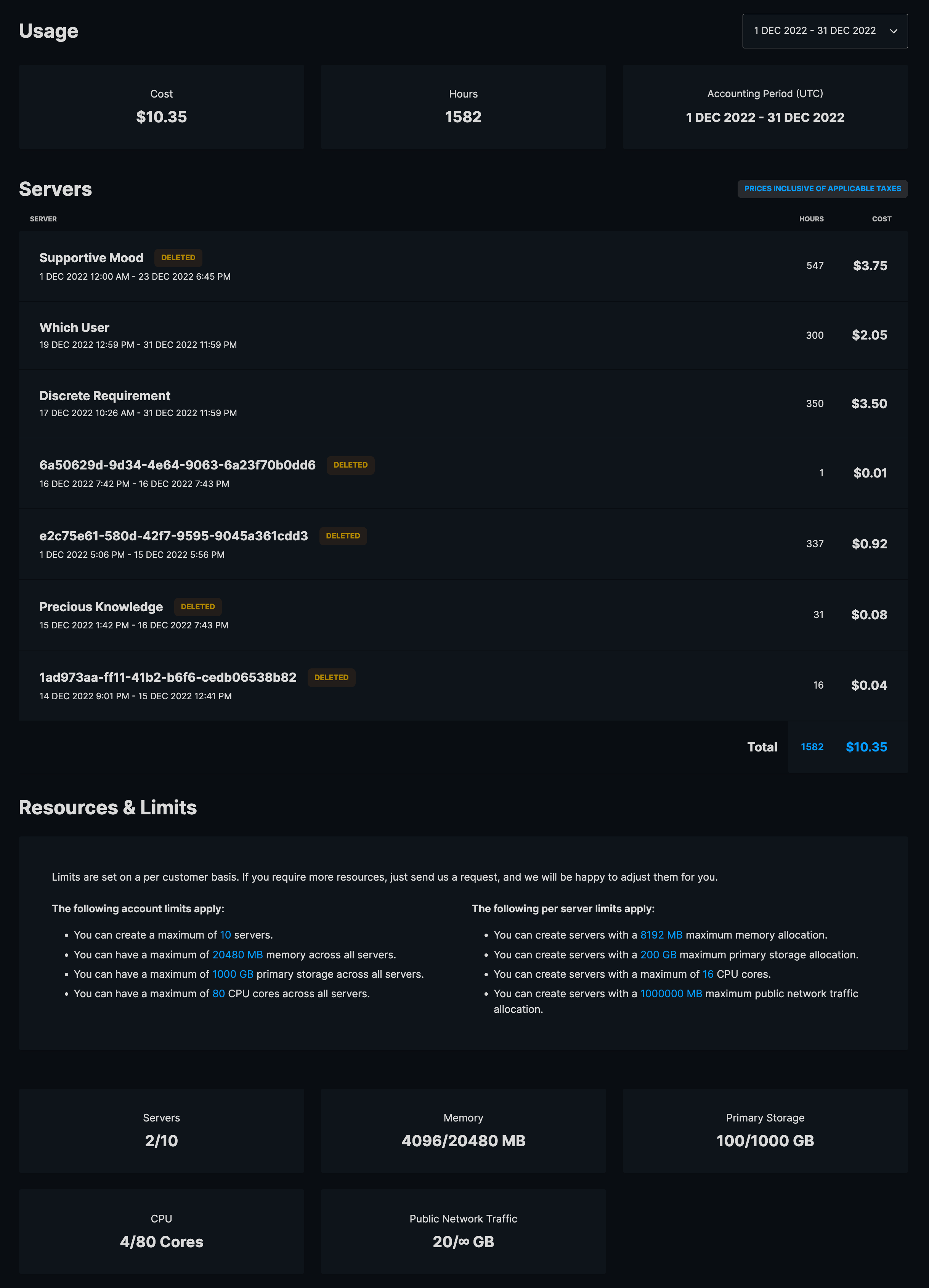

    To me, as a customer, the idea of hourly billing sounds great. If the price is low, when someone does not need resources, someone else will need it and deploy a server. So I don't quite see it as a problem. Besides, if a stable customer loves the service, they will continue paying hourly for a year, or even more.
    The biggest advantage is for a customer who has some automated script to deploy a server and use the resources to an expanding or flexible project, all with just a few commands; then delete it after a few hours or days when server is no longer needed. I don't have such project, but I do believe some experts around here might have such a thing; therefore such hourly flexibility is extremely useful for them.

    So far I loved providers with hourly billing. If the price is low, the resources might not end up unused.
    Problem might be abusers, paying just enough to send spam messages for a couple of hours, then cancel the server to leave the provider with a blacklisted IP, repeating the process every few hours. But this is a different discussion, I guess.
