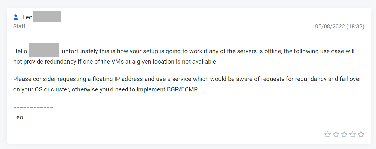

for completion here is answer from support:
btw: this is also not any my complain on this provider or somethng similar, but simple i am asking on this and opinions of some experts on this (knowledgeable people in this field), bcs i do not have experiences with this

    Anycast can be redundant IF THE IP STOPS BEING ANNOUNCED (which should happen on normal anycast setup, router goes down than the IP isn't announced on the specific region).
    However, that requires you to announce your own /24 or bigger block (which is super expensive, and you won't really need 256+ IPs on a single server in most cases), and the router to go down when other systems go down (which should be the case on DC power failure, fiber cut, etc.). So, what BuyVM does instead is announce the /24 on their own equipment, and rent out a single IP from that block. In this case, even if your server is down, BuyVM's router is still announcing the IP block (at least as long as their infrastructure is up), so other routers will still try to reach the specific region that has the closest path.
    On the last part of your ticket, the support rep mentions BGP. This is what I was talking on the top (announcing your own /24). If you establish a BGP session with BuyVM, you can announce your own IP blocks (/24 or bigger for v4, /48 or bigger with v6). Then if your router/server goes down, you will stop announcing your block to BuyVM, which will stop announcing on the specific region.
    IMO BuyVM's anycast is meant for more specific use cases, like DNS or some CDN setup where GeoDNS routing, etc. isn't an option.
    I guess you could do something similar with monitoring + API enabled DNS, or you can get a cheap /48 v6 block, announce it, and connect it via Cloudflare proxy

    @sanvit is correct, BGP anycast is only redundant if you stop advertising the IP prefix from the location where the server is no longer responding to requests. BGP is not aware of layer 4 protocols, so if TCP connections start to fail, it doesn't know to stop advertising the prefix or something. This has to be done by software that automatically stops the advertisement of a prefix when an issue is detected.
    In the case of BuyVM this can't be done because there are several other customers using a /24 anycast prefix. This would only work & be possible if there were one customer per /24 prefix + the automation in place to action it.

    We could re-route, but it ends up with people just using anycast IP's as free IP's. "Oh, I'll just buy 3 VM's, cancel the next day, keep the 5 free IP's".
    Your options are:
    • BYOIP
    • Setup a 2nd VM in each DC and then you can do failover/loadbalancing
    • Live with the current setup
    If a location does go down, the location is pulled from BGP. We also pull locations from anycast if there's major maintenance windows (like when we migrated our racks in LUX).

    The router that announces your anycast is in front of your VPS. The router is unaware if the VPS is offline and will keep announcing the anycast. Any router that is announcing the anycast to the closest route to the endpoint is offering their route to a VPS.

    Traditionally, (b) is correct. However, you could implement (a) via software on the router end. It isn't technically re-routing, (a) can only be accomplished by setting the router proxy/forward the request to whatever node is alive.
    I'll give you an example,
    Let's say you have one node on each region, and LUX goes out.
    (a) could be accomplished by setting the router on LUX to forward the request to MIA, while (b) will just stop announcing on LUX, and the user will directly be routed to MIA.
    So on traditional routing (method b), this will be
    User -> MIA
    while, if you implement (a), this will be (assuming Fran will support it)
    User -> LUX -> MIA
    However, I doubt that Fran will implement it, since this will require extra development (healthchecks, etc.)

    in this case, the IPs are being announced at router which cannot detect if your VM is online or offline... so it's an understanding difference.

    Yes, if you have multiple VM's on the same node we can spread them out.
    Yes, you can load balance the IP's via BGP (we can give you a private ASN), or you can just use heartbeat to do master/slave failover.

    I think the core of your problem is that you are confusing Anycast (routing frontend technology) with Load Balancing (a backend service distribution method). Failover specifically seems to be what you are most refering to and is often placed under the umbrella of Load Balancing (and it's where you will find it in our panel).
    For a anycast procviders traffic to be re-routed away from a PoP that PoP must go offline. Your backend servers online status is irrelevant to frontend routing (instead ensuring uptime in these cases is a matter for failover / load balancing).
    If what you are after is failover and load balancing, it is supported (both failover primary/backup and load balancing active/active modes). You simply enable Load Balancing on the port row and define your load balancing configuration with one or more active backend servers and zero or more backups (HTTP).
    If what you are after is geo routing (using anycast technology) it is available. Along with custom configuration for each PoP at the port level. You simply set the region option in the port row (one entry per PoP required).
    Combining those two - if you want to define a custom load balancing configuration for each PoP thats supported. You just select the region for the port and define a port and your desired failover / loadbalancing configuration for each.
