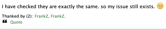

  • @FrankZ said:
    Does
    hwclock --show
    show the same time as
    date
    EDIT: If they are not the same do
    hwclock --systohc --localtime
    I have checked they are exactly the same. so my issue still exists. :)
    Thanked by 2FrankZ FrankZ
